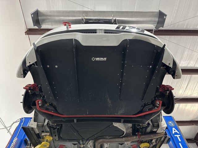

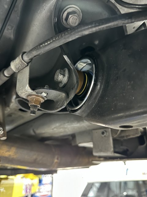

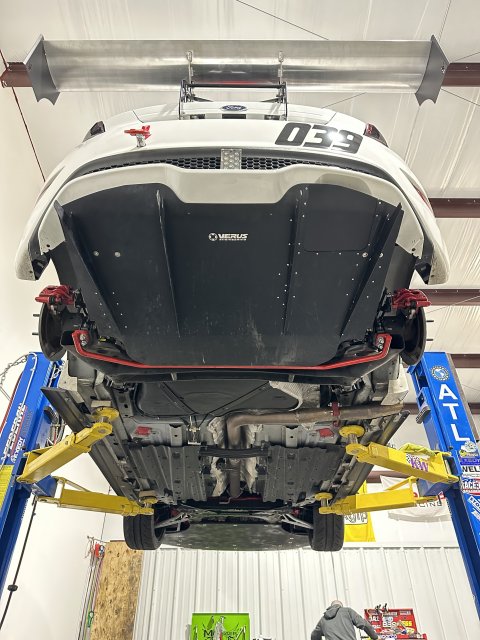

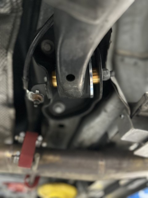

Aside from that, the aero mods and suspension upgrades are just about done. Next track time is scheduled for the end of February at Road Atlanta so I’m anxious to see how it does compared to last year’s setup. I’m hopeful the hood vents aren’t bullshit. I expect to see at least a 5mph increase in top speed with the addition of the vents along with the diffuser and wing braces. All I did with the suspension is increase SWIFT spring rates by 2k (8k front/6k rear), replace the rear beam bushings with DNAs setup and swap the front LCAs with DNA’s as well. I was bottoming out in sketchy turns and could use a little quicker rebound so the additional spring rate should help. Other than that I had zero complaints about my BCBR/Swift coil overs which probably gives me zero internet credibility. 🤣 I might bump up to their digressive set when these are at their end of life. I thought about switching to 510s but I’m really happy with BC.

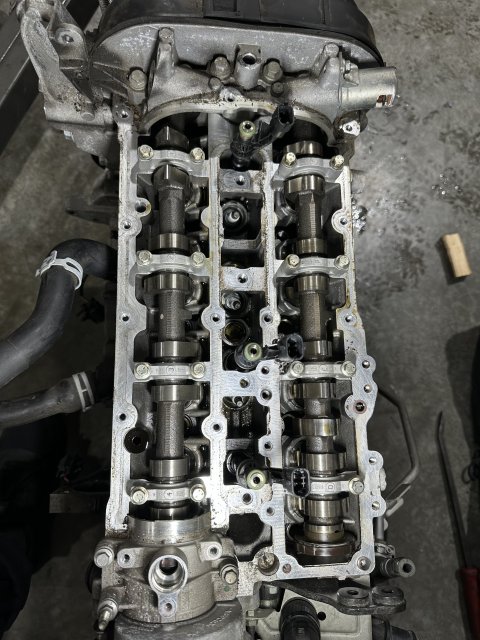

Disassembled my “new” engine to see what failed and discovered ring failure in cylinder 3. No clue about its history but glad to know the damage is minimal and nothing else is damaged. Gonna close the deck and sleeve this bad boy then send it! 71F35429-C45E-4B16-B72D-96EC35055968.jpeg

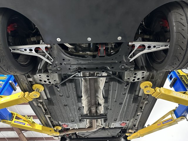

The next thing is to remove the TB Performance parts and build a better chassis/subframe braces. The Pierce 6 point is incredible but hangs too low to work with any sort of underbody aero. I miss that brace a lot. The TB stuff doesn’t seem to make any improvement over stock but the Pierce brace was noticeably better at turn in. We have a plan that will utilize the mounting points used by Pierce but in a much more aero friendly design.

Yeah, NONE of the braces in front of the subframe work with, or clear my skid plate, so I could not use any of them even if I wanted to, and even if they did make a world of difference from stock. [:(]
I’ll take some pics and share our idea with you next time I’m at the shop with the car. It’s not as simple as bolting on a bar but the brackets might be repeatable in small quantities. It’s hard to explain without pics though. The rigidity the Pierce 6 Point provides makes turning this car much more predictable and precise at any speed and I’d like to experience that again. The TB stuff flexes and the material they use seems to fatigue quickly. That’s been my experience with two sets of their braces anyway..

I haven’t run with the hood vents or diffuser yet. I don’t think the car would benefit from a rear wing without a functional front chassis mounted splitter though. I’m actually adding tunnels to mine to gain more front downforce and help balance it out. I have a feeling the hood vents will reduce front downforce a little since they should reduce high pressure on the nose of the car. The tunnels should compensate for that and possibly add a little more. I plan to bring two front blades to test later this month.
My first functional aero mod was a custom extended lip on the OEM wing. There’s a pic of it on my car on the first page of this build thread. The lip helped a little with tank slapping under hard braking from 120-60. As my car and I got much faster I had to rethink aero so I could go faster, safer. Tank slapping was really bad and pushing higher speeds in sweepers resulted in less confidence due to sliding.
