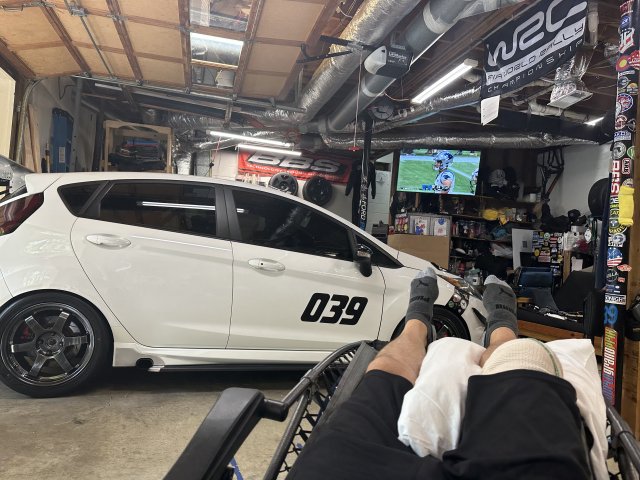

It’s been quiet this summer because I broke my knee. Hopefully I’ll hit the track again sometime in the next few weeks but I’m not gonna hold my breath. Until then I just stare and dream.
That sucks! Hopefully you have a rapid recovery.
