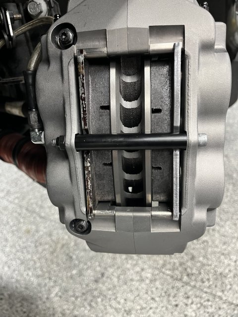

I’m interested in getting lighter wheels, for sure. The problem is that I still won’t know if they clear my caliper, which is huge. It all comes down to spoke shape, and I hate the idea of buying rims again, only to find they won’t fit.
382
374
Northern Virginia
EDIT: Woods, the more I think about it, I’m definitely interested in trying …. But I have doubts. Cutting 5lbs of rotational weight off each corner is big. In a perfect world, I’d be permitted to buy just one and test fit, so that I only have one to unload if it doesn’t clear. That’s how I ended up with the F20s … confirmed one cleared, then circled back and bought 3 more.
Let me know. If it works out, I’d end up turning the F20s into a rain setup with 200tw tires.

I totally get it. Only a couple of wheels clear my brakes without spacers. I have so many spacers from 2mm to 12mm 😂
382
374
Northern Virginia
It's even more complicated for me . . . In order to fit the fat tires in the wheel wells, I have to use a large spacer. Right now, I have a 15mm spacer on the F20s, moving the offset from +42 to +27. Any further out, and I risk rubbing the fender flares. Any further in, and I rub the coilovers. The good news is that the spoke shape of the F20s means they clear the calipers by a mile with the 15mm spacers. In theory, the F20s clear the caliper only 5mm spacers but, again, that doesn't get me the overall tire clearance I need in consideration to the coilovers.
With the 17" Hypergrams I tried, I tried as much as a 20mm spacer, which moved the offset from +40 to +20. Even then, the spokes only cleared the caliper by 1.5mm . . . that's not enough. And, as mentioned above, I suspect +20 offset would have me rubbing the fender flares anyway. So, I had to eat the $152 shipping cost to return the rims.
