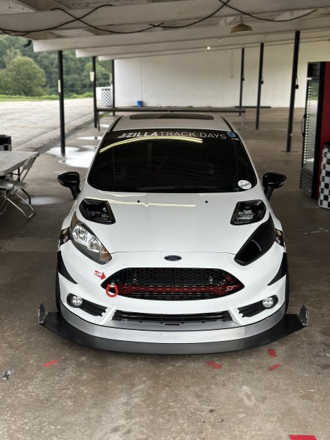

The rear of my car is perfect now. I’m throwing the car back on the alignment rack this week to fix front driver camber and toe after losing grip and slamming the curbs before the bridge at RA. I suspect the rear beam didn’t move at all but we’ll see! I’m still struggling with inside wheelspin. The only solution is a clutch diff. Should I reach out to MFactory about developing one for us? Anyone else interested?
Never mind they aren’t interested. KAAZ and Custco are it I think.

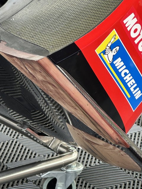

Those wood sliders are a lot thicker than I expected. I guess you want that much for endurance racing.
Yeah they all run max aero at Road Atlanta. Their grip level is incomprehensible. It explains why we don’t see sparks flying through the Esses and the other high speed turns on this track.

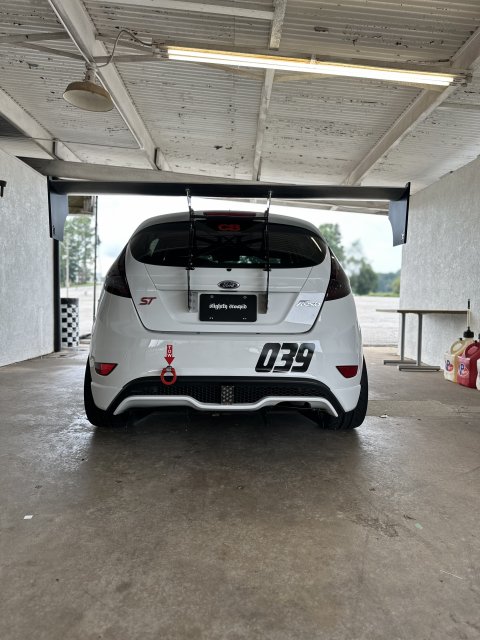

Thread Starter #1,700
Took the party to Road Atlanta today for an open track day. I hit the curbs in T5 and she detected a false crash for the first time on that track. I’m going to wrap the RCM in some kind of foam to dampen the vibrations and see if that helps. I’ll report back after Barber in a couple of weeks. It always does it there in the last turn on the first lap.
