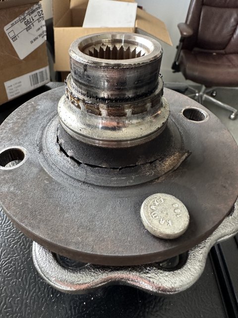

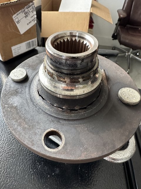

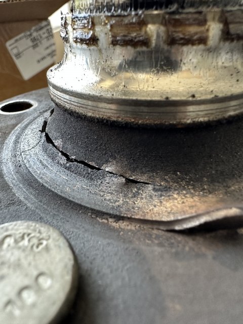

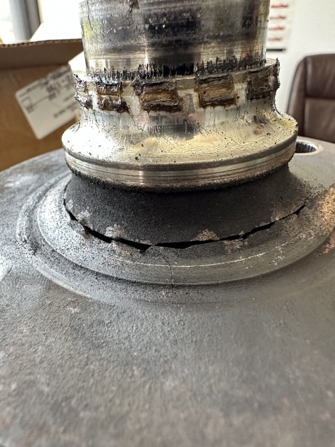

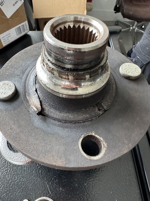

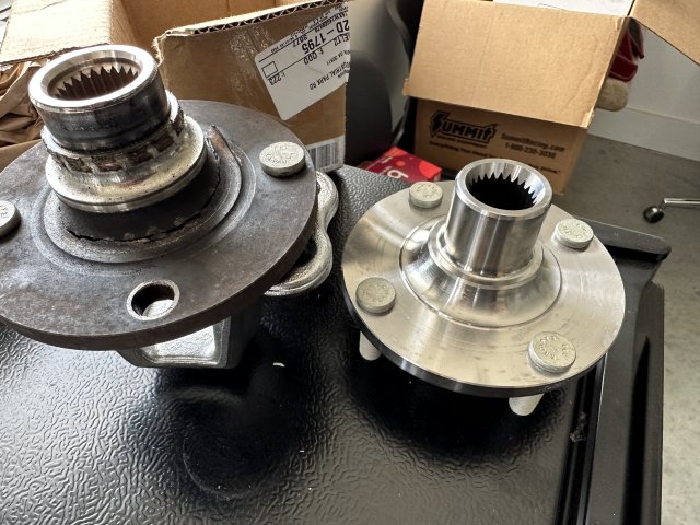

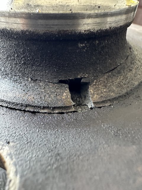

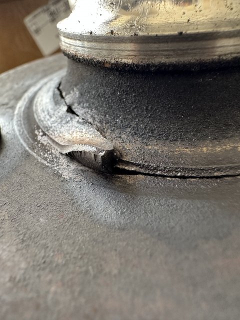

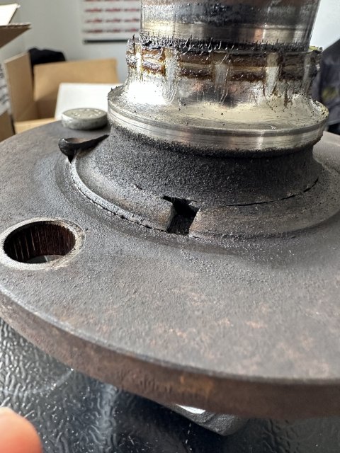

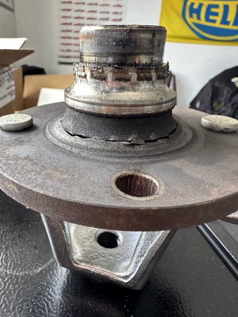

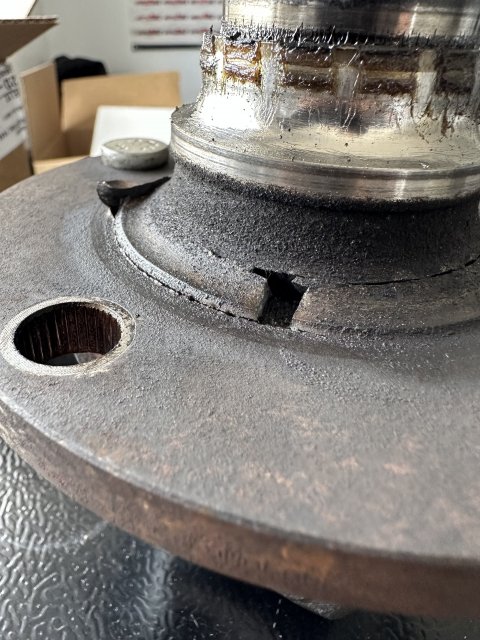

HMMM, looks like that transition from the hub to the face could use a cleaner transition, that is where it broke. Crack propogated in small radius of that transition. Know anyone with a lathe that could clean that transition up and make it larger or eliminate it all together?
Another ticket would be to shot peen the whole hub and any surface that is not bearing or seal surface.
What are you torquing the hub nut to, when you install?

Ford service told me 135ft lbs. Unfortunately I don’t know anyone with a lathe. I figured the old ones had over 30k track miles so as long as I change them every other year I should be good. One was a massive pain in the ass but the others went well. It doesn’t look like Ford sells the rear knuckle (or whatever it’s called) anymore either. They only have the base Fiesta version that doesn’t have caliper mounts.

Probably not. The ST uses the same hub front and rear and the same wheel bearing front and rear. Torque is minimum 255NM or 188lbft according to the manual. Torque it to 200+lbft.
I was wrong. My buddy said he torqued to 188lbft not 135 like I thought. I’ll double check it tomorrow when I swap wheels before the alignment though. Thanks for checking for me!
Edited for my notes: they are all 188
