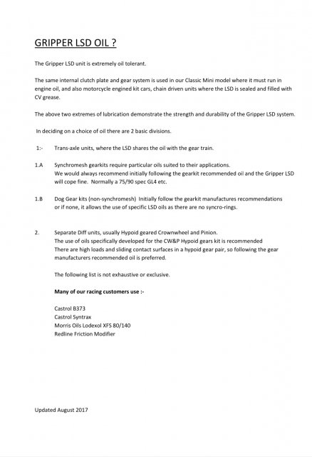

Can you please help me interpret this? 75w90 Motul Gear 300 LS should work right?
14,902
7,351
Yes, the Motul should be fine, except it is a bit viscous for our IB6 boxes, which should not be a problem for you in your locale, and the high temp/very hard use you will put that transaxle through.
I am just wondering how the limited slip additive in the Motul will effect the synchro/blocker ring engagement, if at all. [dunno]
I would contact Gripper, if at all possible, and ask all of these questions, as well as just how much additive is necessary for proper clutch pack function.
(On RWD/separate from the gearbox axle apps, most usually run as little limited slip additive as they can in order to achieve full locking, and only enough to allow for no chatter if street driven, and in order to save the clutch plates from excessive wear.)
(On RWD/separate from the gearbox axle apps, most usually run as little as they can in order to achieve full locking, and only enough to allow for no chatter if street driven, and in order to save the clutch plates from excessive wear.)
I wonder if switching to the carbon sycros is a better option. I’ll reach out to them in the morning. Thanks!!
Dialcaliper
1,153
1,852
San Francisco Bay Area
I would interpret that statement from Gripper as our gearbox falling under 1.A - Syncromesh gear kits require particular oil for their application
In other words, I would not change to a LS oil unless you've already had good luck running one in our IB6, and in fact not change from whatever transmission oil you're running currently if its working well (Motul?). You might get a little less torque transfer action from the Gripper LSD but it's not going to damage it, and the 6-speed will still shift properly. You might find that its a non-issue
I'd talk to Synchrotech - If the Carbon synchros are more tolerant of friction modifiers than the OEM synchros, you might be able to get improved torque transfer from the LSD by using an LS oil with friction modifiers, but I wouldn't sacrifice the rest of the transmission and shift quality to do it, especially if Synchrotech also recommends against it.

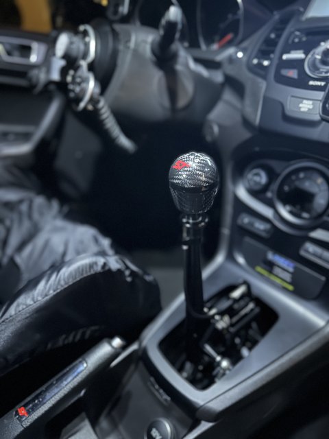

Transmission is in route from Pumaspeed. In the meantime I bought a shift knob from a fellow member, tapped it and installed it on the Coolerworx. Looks awesome and feels awesome. I always missed my carbon ST shift knob after upgrading to this shifter with a monster m12x1.5 thread pitch.
