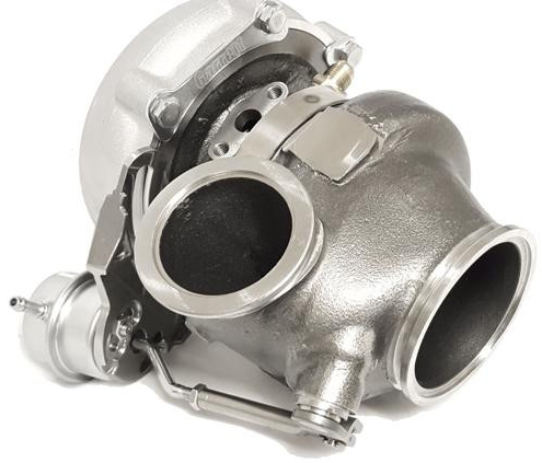

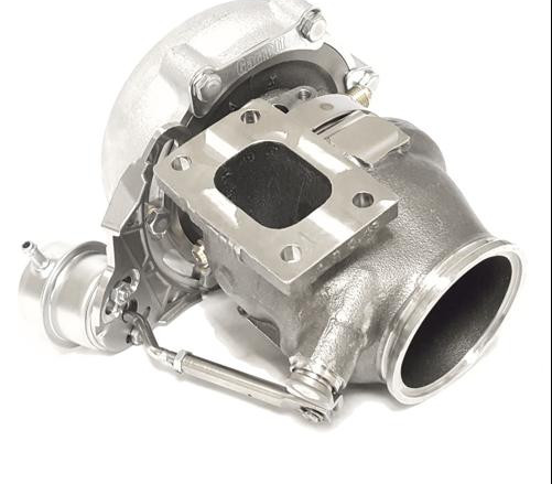

Just reviving the thread again. I have checked out the possible options of the G25 550 - there are a few of which one can choose, and because I want to stay internally gated, I did see there was a .49AR option that looks like this.
T25 option with .49 AR turbine housing
Or this VBand option
I must say it looks amazing
I hope the smaller AR should give me a bit more streetability (Spooltime) - any know of people who have tested the smaller housing? Should I be able to see 400HP?

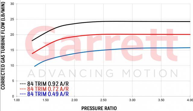

Can someone also please explain to me the Graph below? Would choosing the smaller AR be good or bad?

End up with an ATP type adapter* Or have someone weld an V--band flange on the stock one* Others have done this with success.
