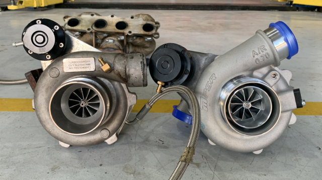

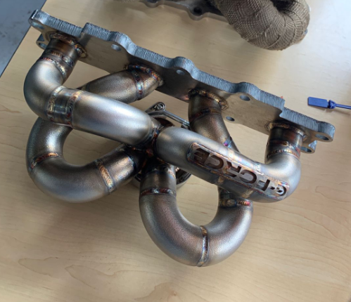

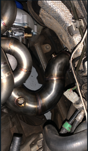

Soo just to post an update on the thread, Pulsar 4849 fitted (G25 550 replica) with new tubular manifold and the R&D to get it in. Running an external DV and GFB Boost controller. Tuning will be done hopefully end of Jan.
Some pics to share
Some pics to share
View attachment 53286 View attachment 53287
At first mention of a G25 build I was curious. But now you talk about this Pulsar 4849 and you have my attention...
edit: what turbine housing and compressor housing do you have with your Pulsar 4849?
