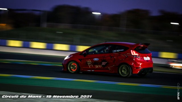

Not A052 because explosed at the last circuit :LOL:
So, I tried ZESTINO (gredge semi slick) in Soft 215/40 R17
the tread is narrower than AR-1 or A052
but I think my recent geometry with a lot of caster and 3.5 ° of camber with my new DNA adjustable Uniball suspension arms + adjustable rear torsion bar brought me a lot .. the tires weren't screaming!
great feeling!

Exterior :
-Front Rear Maxton Design Bumper modified
-Extended Fifteen52 fender adapter to my 3 door European Fiesta ST
-Sideskirt Triple R
-Hood Event
-Wing RS style
Engine
-Stock Engine, but Uprated camshaft pumaspeed (+20%fuel Flow)
-Sparks Irridium NGK IX
-Turbo X58 Evo2
-Forge DV (or Turbosmart dual short Kompact)
-Quickspool Manifold pumaspeed
-KMS Hurrican Exhaust
-Injectors upgraded
-Big boost pipe and silicone Hose
-CAIS ITG
-Crossover Forge
-Universal Intercooler J-line from Mishimoto
-Triple Pass Radiator (water) Alu
-Silicone water hose
-Oil Radiator (16ranges)
-oil catch can
-Air conditioning removal
-Litthium 2Kg battery
Gear Box
-SPEC Stage 3+ clutch
-SPEC Alu light flywheel
-Quaife ATB
-Coolerworx shortshift
Chassis/Brakes
-Spacer 20mm
-Wheels Team Dynamics Pro Race ET30 7.5x17
-DNA Adjustable Arms UNIBALL
-Silent block engine Vibratechnics
-Eibach anti-roll bar front
-adjustable link bar
-SUMMIT Front rear upper strut bar
-6 point reinforcement under frame
-powerflex Black Serie rear silent block
-DNA anti-roll adjustable rear
-DNA Rear upper strut bar
-DNA Racing rear camber plates kit (Camber)
-BC Racing RA coilovers with camber
-Big Brake Kit 330 AP RACING CP9200
something like that 😆
-Sparco Grid seat with HANS and Harness also
