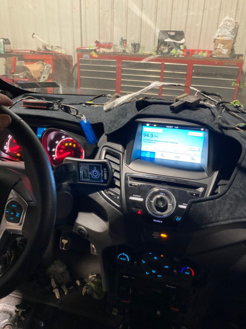

I discovered that I can not use the 11 roof rail airbags with the 19 ST harness. The connector is different. Good thing I kept the 19 bags.
#12508
403
354
#88
Can you splice off the connector from the bags in the ST and swap it on?
Or repin it if thats an option to
Mike King
#23177
271
628
Thread Starter #89
The 19 ST roof rail bags mount exactly like the 11 Sedan so I'm using the 19 bags.
