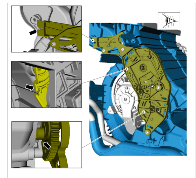

Hi everyone,
Is it necessary to check these before fitting the Air Distribution/Blend Mode Door Actuator or can we fit it by setting the controls to something specific to get them to align?
There is a video here as well about it here but he only checks 1 position and uses the controls as well so its not quite clear.
Ideally, none are required and I can just move the large gear until the old one fits but I'm not sure if this skipping of gears (clicking) has put the positions out of whack
Thanks
