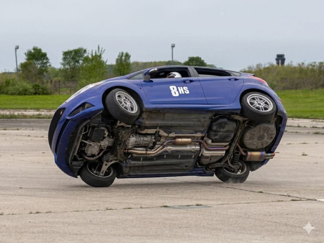

Well, it finally happened - I had a big two-wheeling incident in AutoX. Grissom aeroplex, so very grippy concrete. New-to-me RE71RSs on 16s. First run on them, had a tank slapper in a chicane as the tires were warming - nothing unusual, and I don't mind getting the rear out in this car. When it swung back the other way the driver's-side tires hooked up, and up it went.
I was able to ride it out (those years of two-wheeling a four-wheeler in high school paying off? Or just lucky) on two wheels.
The passenger side came down hard. Shrugged in shock to the corner workers, and then completed the run w/o red flags.
I'm not sure of the takeaways to be honest. I'm running Koni yellows full stiff, no rear bar, and have 4 years of experience in this car. It felt like a fluke, but a sobering one at that.
This is a forum, so we'll all have our advice or theories - that's ok. And I had a great rest of the day driving (including fun rain runs!). I wouldn't dissuade anyone from running this car, but I do wish I could get the roll center down a pinch.
As MG's motto as it - Safety Fast!
Pic of AI slop of my car on the corner. Like the longitudinal trans and inboard rear springs? :-O

My only thoughts are maybe full stiff on the susp isn't the way. you need more pliability especially when going 10/10 on a flat surface. Just a guess though.
Dialcaliper
1,183
1,886
San Francisco Bay Area
It’s for rebound, not compression. But who knows…
Especially on a rough surface, cranking up rebound without adding compression will cause your outside wheels to “jack down” or basically suck down onto the bumpstops until you’ve got no suspension travel left. Not saying that’s the cause of the incident, but probably didn’t help.
One big problem with Konis is that everyone somehow thinks that “full stiff” is like turning them up to eleven and somehow better than finding the proper tuning to match your spring rate, which is the least amount of damping that will keep the spring and the car body from oscillating on settling into a turn or on recovery after a bump.
I always recommend with Konis to start at full soft and dial in just enough until the car feels stable and confident. Any more than that and you’re just making the ride stiffer and more uncomfortable without making the car faster
Autocrossers apparently do this on purpose nowadays. At least Miata owners do. It's discussed all the time on the Miata forum.

For sure. Without a proper test and tune, it’s a crapes shoot. Working with a skid pad to see where it breaks traction (front v rear or neutral) would help. Then slalom work to see how it transitions.
That would be great for a nationals prepped car. For me, running about six autocrosses a year, it’s simply not in the cards to get this sort of tuning in. Perhaps someday.
I will say that the konis have been great since I daily this car and have to handle expansion joints and the porpoising that you and I have talked about @Dialcaliper . But adjusting the rears is a pain and generally only gets done a few times a season. So that affects the ability to test in tune. The fronts are much easier and I would like to experiment around with those - but again, I only get so much time on course, and adjusting tire pressures is much simpler
Last thing, it does seem that the compression on the konis is considerably softer than OEM. Overall, it feels like the car was better for autocross stock, but it’s become a much much better daily driver with konis. I suppose I could get them revalved somewhere to get some of that turning back.
