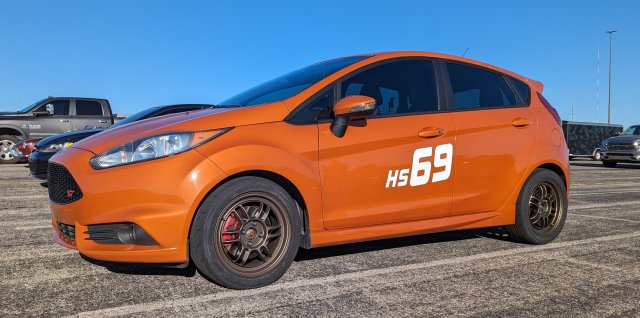

Sounds like your ride height is too low &/or not enough negative camber. At stock ride height I have 12mm spacers on all 4 corners, my DD setup is 16x7 +43 w/ 215/45. No rubbing at all, ever. I have a few corners nearby that I see everyday with big compressions midway that can nearly bottom out the suspension with 4k/5k spring rates. I ran these same tires on 16x8 +40 on track, no rubbing at all.
A 205/45 or even 195/45 will be lighter, respond sooner and have better lateral grip. I only have a 215 on to protect the wheel from curbs for daily duties.

You should have no issues rubbing with the 215/45/16 on a 16x7 +43, that's what I and most people run in HS.

Yes, that tire size with Enkeis are what I’m running, and what most run. 17s are actually very good if you can get a light option (13-14 lbs a wheel), but they are pricier, as are the tires.

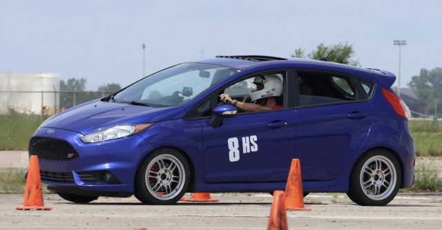

I ran higher in the rear, usually only around 5 psi more. I also ran the eibach rear sway bar, you really need as much rotation as possible for autocross. Some competitive fwd drivers even run a less grippy compound on the rear (ie PS4s) to get even more. And yeah the civics are the dominant HS car rn, that's the main reason I took mine to STH where it's also not competitive but way more fun to drive at autox and the track.

Yeah max for the class for fwd is 265s on a 9" wheel which isn't possible on stock fiesta fenders, but easy for the civic SI/GTI which also have more power. AWD can run up to 245. There's also not a lot of options in the 15" range as Bridgestone doesn't make a 245-40-15, and to get a 9" wheel you have to go custom. I ran the falkens but they're definitely off the pace compared to the current top tires. I think it's the most fun to drive car in the class and can hang on tighter courses but definitely not the best choice to be fully competitive. My best results at a national course/event were about 2-3 secs behind the leaders.
