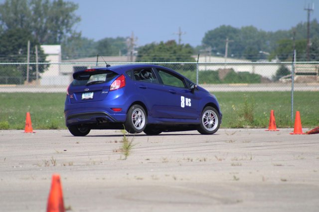

I autocrossed for years and I did see a lot of fwd hatchback being tripods for a second or 2.
Tripod is normal for a FWD driven hard. I never worry about when on three wheels. Two wheels is an entirely different situation and it does happen sometimes with a Fiesta in autocross, but its exceedingly rare. Lot of it depends on your tires and driving style.

I run stiffer than stock suspension, I 3 wheel the car every run. I have been told that I've had it on 2 wheels on occasion (I could not tell while driving). 2 years ago, a novice driver rolled a fiesta at a neighboring autoX course. These cars can roll but it takes a combo of sticky tires and a series of steering inputs that gets the car to rock side by side a couple of times (more so than a standard slalom)
If you are extra concerned, get a feel of the car autocrossing with a more street oriented tire. Move on to the A052's or similar once you have that comfortable feeling.
