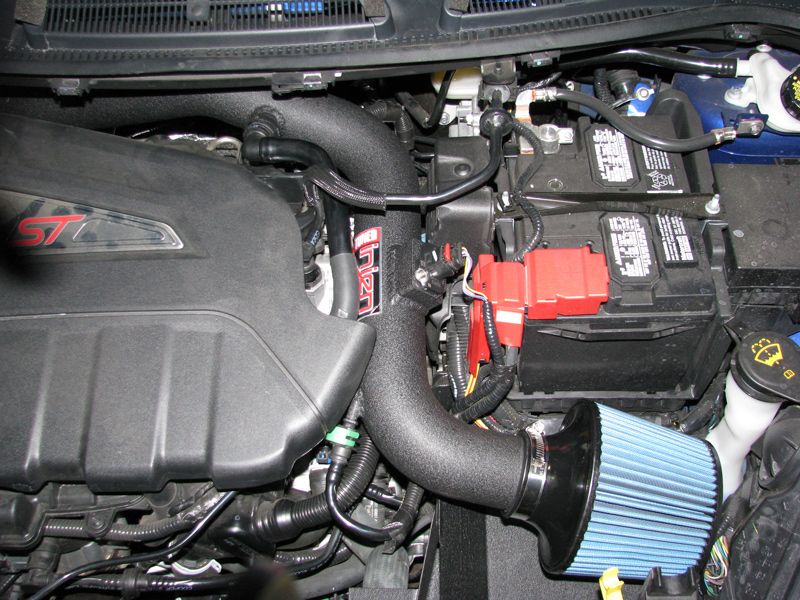

Have you ever heard a 2J? There are loud intakes, then there is the 2J. It does offer an advantage by not having a crossover pipe on top of the hot exhaust manifold, but the cone filter is small so not sure how much airflow benefit vs st200.
I've not heard one in person. I liked my car when it was basically straight piped for a number of weeks so I may tolerate the extra noise just fine. Free.99 is a pretty big motivator to try it.
I've read it generally has the lowest IATs, and to some degree intake size sounds like it's not as big an issue being forced induction (within reason). I'm not big on cone filters, especially not one in the bay, but I could be willing to try where it goes.

It’s worth a shot then if you don’t mind lots of noise. It will definitely help temps. Make sure you get a filter sock to prevent water from getting sucked in as well.

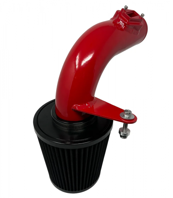

How good are you at troubleshooting shit that doesn’t fit properly? I have a 3” diameter 2J lying around but it’s been modified specifically for my turbo kit so it’ll require figuring out how to extend it via a coupling and some more 3” silicone plumbing so it fits your turbo
I like to think I'm pretty good at it but I'm also very prone to starting and never finishing troubleshooting lol. It would depend on how much you want for it, and if I'll actually finish making it work

Does anyone have an installed picture of the Whoosh short ram intake with the Tube? i am trying to see how it mounts with the supplied Bolt..washer and nut.
