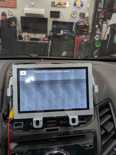

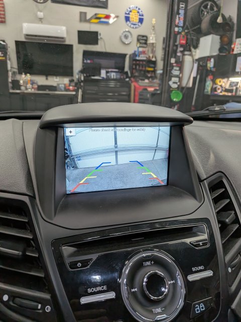

Checking through the settings, I see that there is a camera settings option now for camera delay, but still no response when shifting into reverse
Changed my wires to tap into that purple/black and blue wire like in your picture, and even checked them with a voltmeter, but still no response
Even if the camera isn't set up correctly, it should still be doing something when I shift into reverse right?
