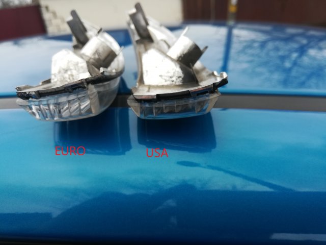

Alright guys!
We are installed! As we were hoping, these will drop right in and replace the stock indicator housing, getting rid of the chrome and giving you a sequential indicator! Very happy with it so far. I will report back after some time to let you guys know how these hold up. Hardest part of the install was trying to pop the clips on the wing mirror caps trying not to break them since it's pretty cold on Long Island as of late. If you guys want me to take any more pictures of them let me know and I will!

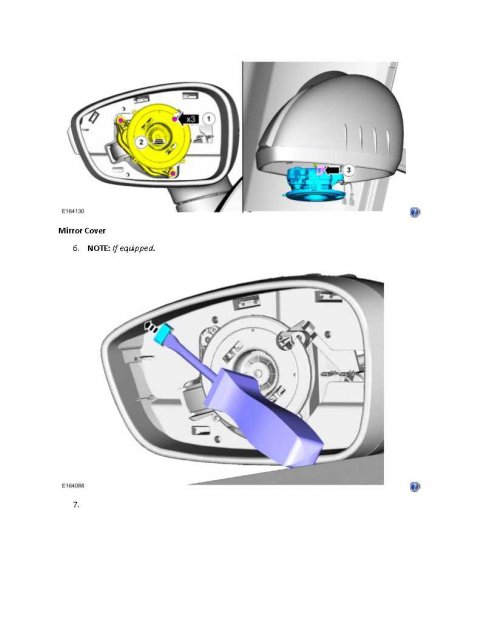

#38
Mine arrived today as well. I had a few minutes to look at it, removing the plastic retainer was easy but getting those three clips out not so much. I spent about 10 minutes but needed to quit so I will tackle it later. On my car anyway it’s not as simple as push the tabs and pop the trim piece out, they are quite tight.
The instructions show removing the mirror panel all together for more room but that is on the European model, does anyone know if it simply pops off on our USDM model as well? That would make it easier.

#39
It does not appear to be possible to remove the the indicator without removing the cap. I also cannot find proof anywhere that the mirror glass is any different that the Euro part. But there are some videos online that show that you should just be able to pop off the lens. But to avoid that, If you aim the mirror down and in that should afford you enough space to pop these clips with a small screwdriver. What I did was pry each clip in a line one by one, and once I knew they were all pried a bit and just about ready to come out, I put a little bit of force into the outer most clip (pushing forward) with the screwdriver and it popped right off. Bear in mind after those 3 top clips come loose, there is also the little side clip and two little clips on the bottom seemingly used to locate the cap when reinstalling (Picture attached noting the locations on these clips).
