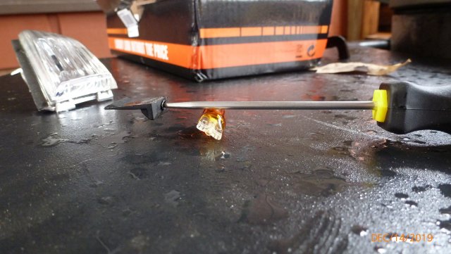

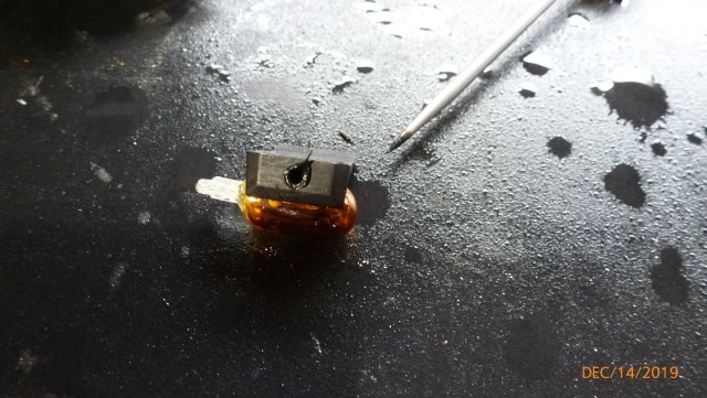

Just made a short video of removing and reinstalling the locking tab without removing the mirror. Torch and a straight pic for reinstallation. I did not use the plastic pry bar that came with the indicators, just a flathead screw driver, a curved pick and a straight pic. No video of me using the torch to heat the pick and sticking it into the locking tab, was a little hard holding the camera.
