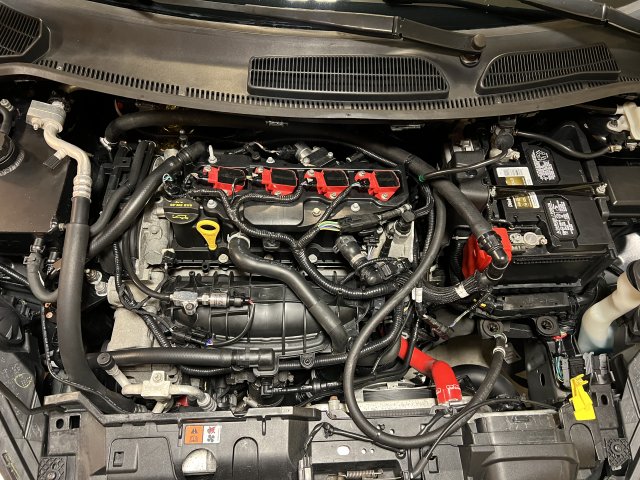

Hey Guys. Just bought a Fiesta ST at the weekend. Its apparently got a few mods and runs on e85 (that's what the dealer said) but after having the car for a couple of days , i'm wondering if he knew much about the car at all.
It has a bunch of stuff under the hood with 'dizzy tuning' and 'whoosh" on it but i'm VERY new to all this. Cheers, Corey IMG_1365 (002).jpg

Welcome.
I can see a red radiator hose and replacement coils. Those are from Whoosh.
The engine plastic cover is obviously not there.
Dizzy is a tuner, so it may have been tuned. Did the car come with an accessport?
#4150
14,805
7,263
That car could possibly have a hybrid, S280, or even a bigger turbo yet installed, since it does have some of the visible 'ancillaries' needed to support those larger and more powerful than factory snails.
I see an aftermarket MAP sensor setup, and a Mishimoto or Radium oil/oil vapor catch can, as well as Whoosh Motorsport aftermarket coil packs.
There is also an aftermarket coolant overflow tank (either a Mishimoto or Pro Alloy by the looks of it) since our factory one, which is translucent plastic, is prone to cracking over a long time, especially in very hot locales.
It's hard to tell from that under hood pic, but it could also have a single port auxiliary fueling.
Did you get a Cobb Accessport hand held device with this car??
IF it is actually tuned for E85 fuel, you MUST have one of these, so that if you ever have to run it on a lower ethanol content, or 91/93 octane totally non-ethanol fuel, you can switch to those tunes, which are radically different from the E85 tunes.
Can you see a polished aluminum radiator top (possibly with a big M on it) through that semi-circular cutout in the radiator cover top?

Has a 2J racing intake for sure. Dizzy’s AEM MAP sensor leads me to believe it may actually run e85. Probably a big turbo under there. Gotta figure out what all the mods are then tune for them. JST is local to you and one of the better tuners for this car. I’d hit him up.

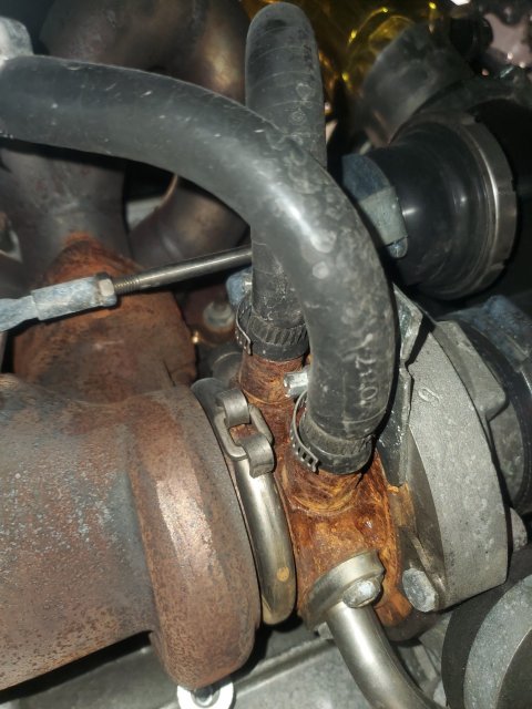

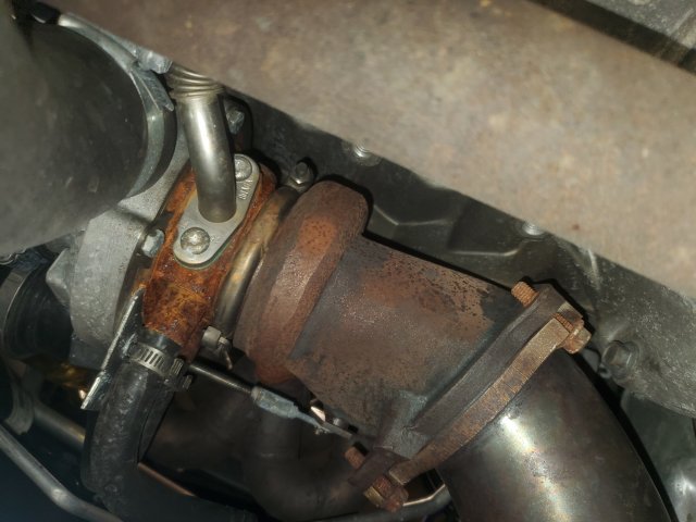

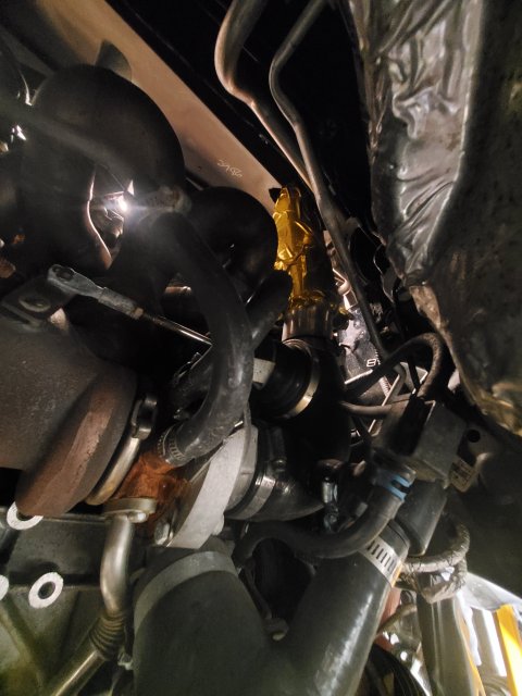

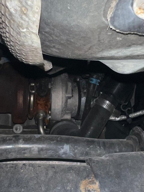

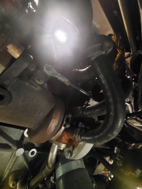

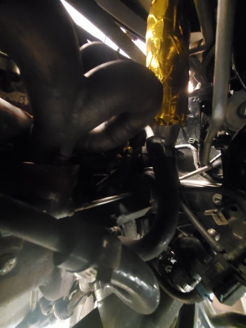

Thanks. Haven't a clue what the stock turbo would look like but I'll post pics in case you guys can enlighten me.
So, it is running a bit better since I drained the tank and put half a tank of 93 in. I did take it out briefly this evening and it pulled pretty good. I didn't really hit it hard through the gears because the backfire frightens the life out of me lol. It was definately better although far from perfect.
I am actually getting code P0171 which I believe is too lean air/fuel.
Friend of mine said to check maf sensor. Think I'll just get a new one to rule it out.

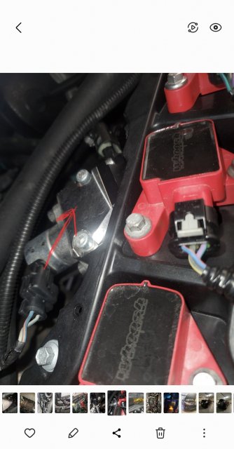

I think I do have an aux fuel port. Just behind the coil packs there is a black spacer under a unit of some description that has a line going to it.
Sorry if pics are a bit large.

I think I’m looking at an S280 or X47 and airtec manifold? The thing you pointed to in the pic is high pressure fuel pump. It looks like an aftermarket one meaning you probably have +30% injectors also. Good mods if so!
yup that sure looks like an S280 I can tell by the very familiar piping.

That definitely looks like an airtech or similar tubular manifold with a stock turbo flange. The black and silver actuator on the turbo is definitely a turbosmart (it will be engraved on the far side)
Definitely not a stock turbo (stock has a diverter valve port on the outlet). Looks like an S280 or similar turbo. The little rectangle boss on the aluminum compressor housing (near the inlet hose clamp) may have a nameplate on it.
Odds are with fuel pump and injectors it’s tuned for E30 (or even E40), not E85. Definitely not 93 pump gas, especially with the lean condition. I’d suggest filling up a tank with 3-4 gallons E85, the rest with premium and see how it runs. Run a couple of tanks before you give it sauce as the fuel trims are probably skewed by incorrect fuel.
Looks like definitely an extensive set of choice mods. As long as they were competently installed and the engine wasn't damaged being driven since the owner ditched it, it can be reasonably reliable if we’ll cared for - correct fuel is the biggest hazard.
Also, with that high pressure fuel pump and maybe injectors, the engine will NOT run properly on a stock tune or any standard tune, so I wouldn’t chance that.
Step 1 is get an Accessport. Step 2 is unless you’re absolutely confident of the tune, catalog the parts and contact a tuner for a new tune. You can get it tuned for 93 octane no problem, though the fuel pump and injectors won’t be well utilized unless you run some ethanol.
If you are able to get in contact with another Fiesta ST owner in Georgia, it might be a good idea to have someone look it over who either has a stock car or knows what to look for to figure out what other mods might be hiding in there.
