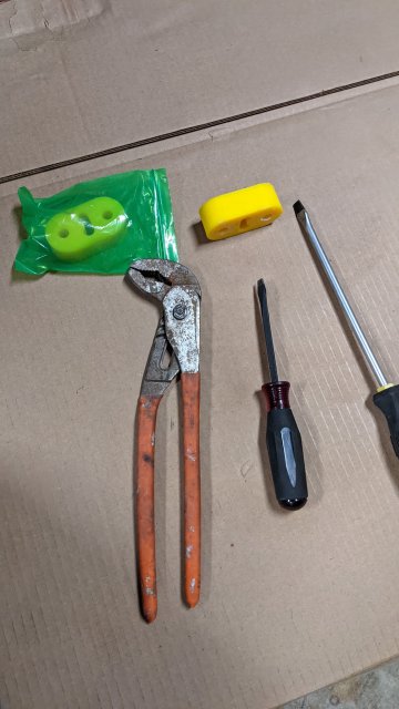

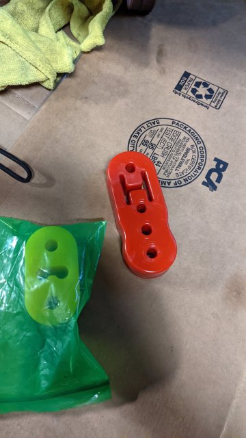

Finally dialed in the stock exhaust and Curt tow hitch. I had the cobb exhaust on my first fist and never had issue, while this 2017 I have now has the stock exhaust and it was banging for about 2 days while testing. Now its completely fix. This is what I did and it will work for everyone.
Buy a whoosh poly exhaust hangars, and buy an amazon poly exhaust hangars with 3 different settings, to drop the stock exhaust can slightly.
Take the old rubber hangar and cut them into 3rds or halves to limit side to side lateral movement. I saw someone on this thread do it and it was a great idea!
This setup will really keep the muffler from moving way too much and drops it slightly to add a buffer for any movement.

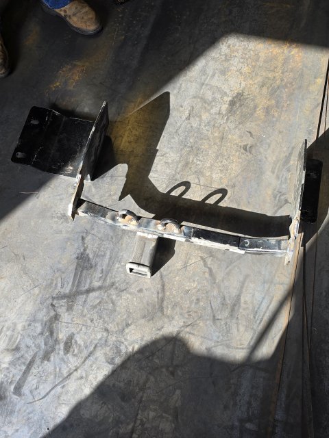

Hello all, I figured I would add in to the hitch issues. I installed a draw tie hitch from etrailer. I used it primarily for a two bike carrier for my mountain bikes. It did work, but it bounced a lot and made me nervous and I hated how low it sat under the bumper. I also had a fork mounted rack for the roof, but it is a huge pain and i lost almost 4mpg with the rack on and no bikes, and almost 6 with the bikes. I decided to take a page out of another members book and make my own. I did use the original hitch, just cut it up and used it how i felt. Also, I have a X-force varex muffler 3" in and 3" out, with a 3" pipe from the turbo back. It did bounce around like crazy and irritated me. The muffler is significantly larger than the stock and barely fit in place before the hitch. I had to cut part of the bumper and some sheet metal. But it does fit and sounds great. I posted pics of the transformation below. I also wanted to mention that it does not move at all now.
To fix the muffler hitting, I ordered some hangers from whoosh motorsports, not a sound out of it since. And it sits in the correct location.
Everything is still bolted on like the original hitch, I just cut and welded the original so it fit inside the bumper cover. When its not in use, i use a rubber hitch plug. Just to mention, It did get painted before the bumper went back on.lol
Thanks bro! Just showed your pics to my welder and he got it done πŸ‘πŸ»
