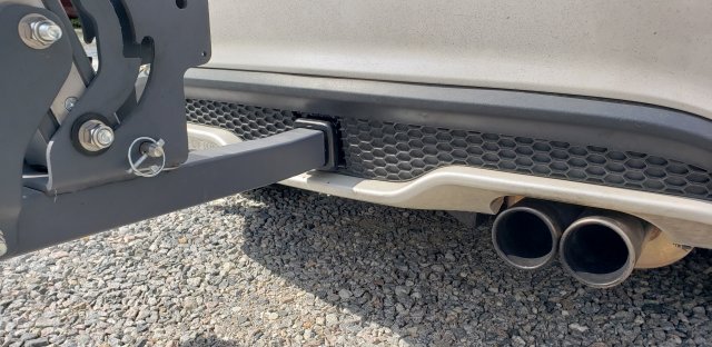

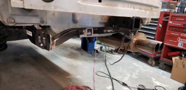

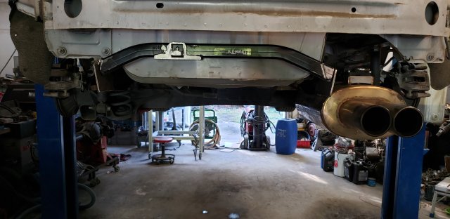

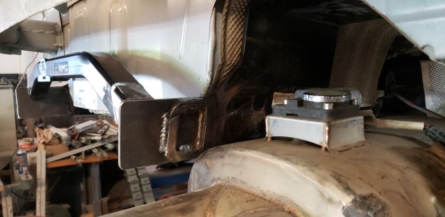

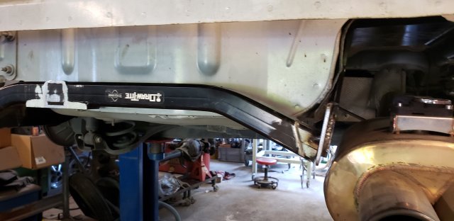

Hello all, I figured I would add in to the hitch issues. I installed a draw tie hitch from etrailer. I used it primarily for a two bike carrier for my mountain bikes. It did work, but it bounced a lot and made me nervous and I hated how low it sat under the bumper. I also had a fork mounted rack for the roof, but it is a huge pain and i lost almost 4mpg with the rack on and no bikes, and almost 6 with the bikes. I decided to take a page out of another members book and make my own. I did use the original hitch, just cut it up and used it how i felt. Also, I have a X-force varex muffler 3" in and 3" out, with a 3" pipe from the turbo back. It did bounce around like crazy and irritated me. The muffler is significantly larger than the stock and barely fit in place before the hitch. I had to cut part of the bumper and some sheet metal. But it does fit and sounds great. I posted pics of the transformation below. I also wanted to mention that it does not move at all now.
To fix the muffler hitting, I ordered some hangers from whoosh motorsports, not a sound out of it since. And it sits in the correct location.
Everything is still bolted on like the original hitch, I just cut and welded the original so it fit inside the bumper cover. When its not in use, i use a rubber hitch plug. Just to mention, It did get painted before the bumper went back on.lol

Love it, with the exception of accessing the hitch pin. But..... what sort of weight ranges are you going to load test the tongue and tow with? 300-400 tongue, etc. 2 ton tow, etc.?

Your are right, the heat shield was never the problem for noise. I believe it was recommended to make the install easier. I would try the motor mounts from Ron@whoosh before all that. Like i said, even with the larger than stock muffler, i get no noise.

I cut a half circle for the hitch pin. It isnt too bad to get to, and the car is stock height for now. As of now i carry a rola two bike carrier. The rack is roughly 65lbs and the bike is 25ish. Ive had two bikes on it exceeding 110lbs on the tongue. As of now it hasnt moved. I didnt really build it to pull a trailer, although i do have one i plan on building soon to accommodate a roof rack and kayaks for camping. I just don't know that i will put it behind the FiST.
