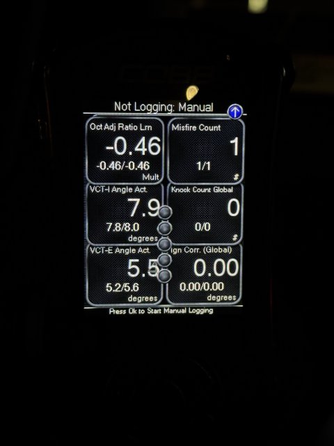

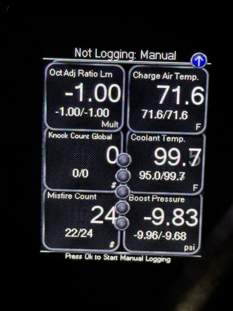

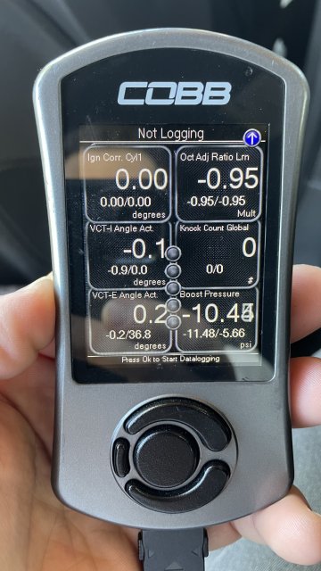

I am getting some gnarly Negative Corrections across all cylinders, and my OAR spikes when trying to go WOT.
Some back story here as I believe it matters Highly.
My Fiesta is a 2014 with 67k on the ODO. It was running fine but then I went to get a Turbo installed (Whoosh Hybrid), with an Airtec Manifold and Whoosh 3” Catted DP.
When uninstalling the stock manifold, the shop found a broken manifold stud. They attempted to drill it out but ultimately hit a cooling jacked in the head. They owned up and replaced the head in full along with doing a new timing belt, water pump, and tensioner from ford (The entire whoosh timing job kit).
I flashed on my new tune from Tune+ once the car was back together and bolted up.
I am getting a jumpy idle and misfires.
Under heavier load, I am getting negative corrections across all cylinders, and my OAR is jumping to +1 almost instantly.
Adam advised checking the plugs to ensure they weren’t over-torqued. I Checked them (Ruthenium) and after seeing no issues, I reinstalled and torqued to spec. This did not fix the issue.
I ran my tank to empty to double check gas as that was the next thing Adam asked to make sure I didn’t have a blonde moment at the pump. I did a 93 with a gallon and a half of Ethanol just in case the prior tank was just dog water.
Issue still persisted.
I then switched to iridium plugs just in case there was an issue, but same exact thing.
Here is a paste bin to my current mod list…
https://pastebin.com/KjAH8wB0
I am getting no Knock Readings currently according to my AP and AFR looks okay as far as I can tell.
Now I am left chasing the issue and I need some help / guidance from the community to help me track this issue down so I can put down my damn power already!
I appreciate anyone’s help in advance.
Big Update :
Ended up getting a new tensioner (from Ford) and belt for good measure before checking everything.
Timing was off by a half tooth to a tooth. Undid everything, lined everything back up and in time, turned the engine a couple times manually to verify it stayed in time. Bolted it back up and then tried to crank it.
It sputtered but did not start. Pulled the Crank Pulley and re-aligned the magnet and viola, we started up.
Now for the big question… did this fix it?
Yes Sir!
I read somewhere else on here about an issue with a bad tensioner and the same off timing issue so it seems to be a semi- common thing with the tensioners.
now to get back to tuning and then working my way to a transmission overhaul!
