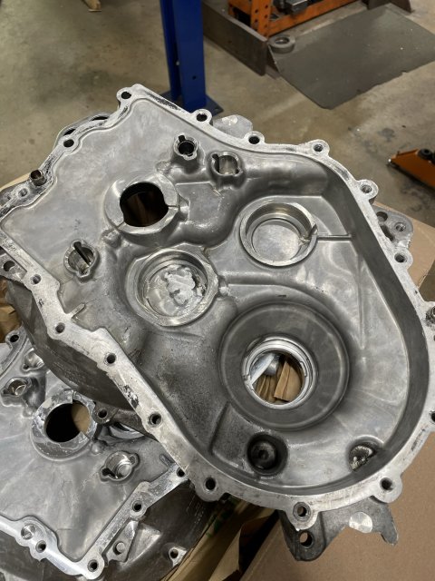

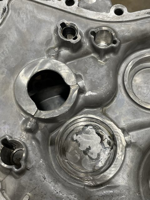

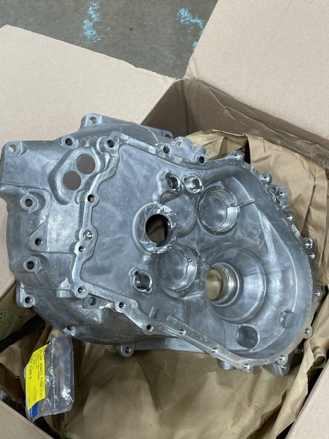

FINALLY. After multiple tries at getting the damn trans case to seal I gave up and ordered another case from FERD. Seems like even getting a pressure proof weld joint, when the bearing went in something opened back up and fluid starting leaking out after I installed the transmission. Talk about soul crushing.

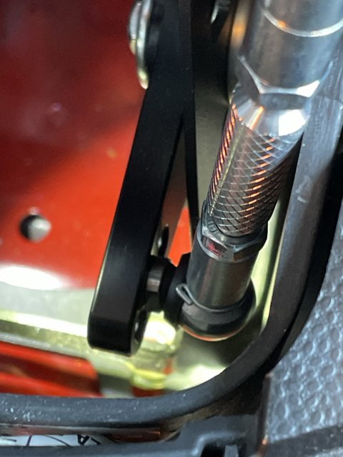

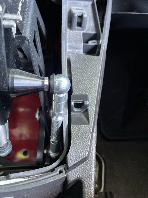

Now the car is back on the ground and I am finally driving my car again. Its so nice. Got the shifter properly adjusted and its so money. Love driving it with the Coolerwerx. Does anyone else have this issue with the dog bone rubbing on the side of the console trim?

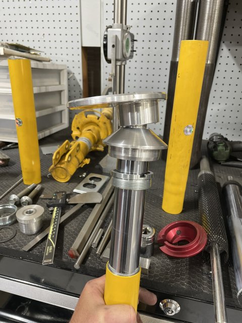

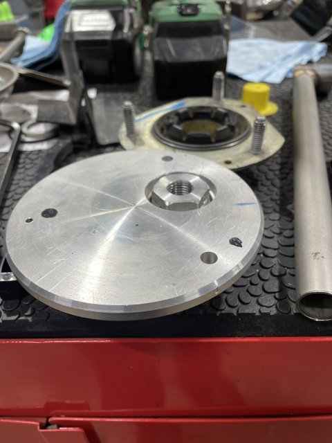

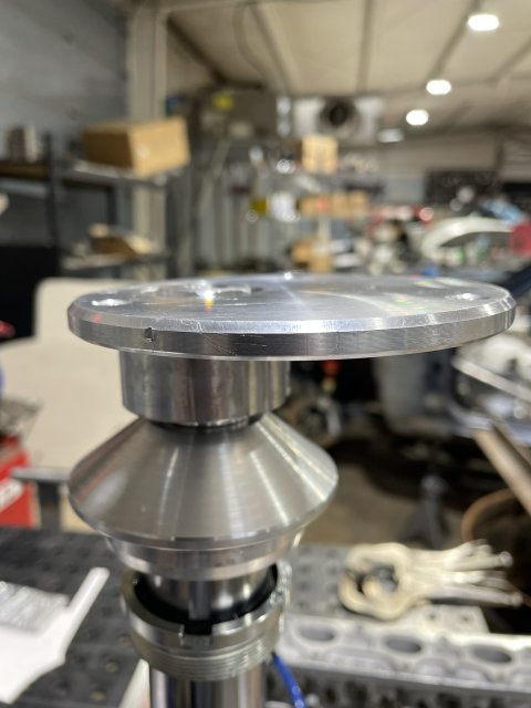

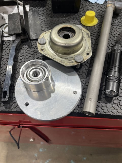

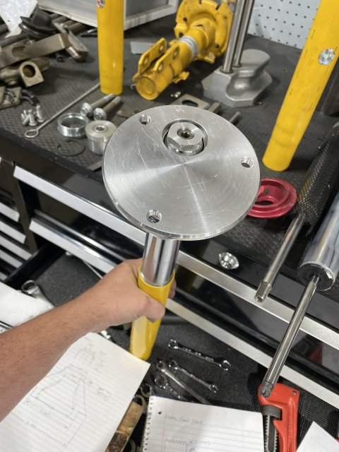

New front camber/caster plates with a Spherical bearing
A new spring perch for the top of a 2.5in race spring. I made adapters for my previous setup to use the stock top hat.

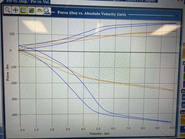

I built some rear shocks before that I never got to test so I am going to try them out after the last round of dampers I had. The had too much rebound and the car wouldn't loosen up like I wanted on corner entry. I replaced them with some plain old stock dampers and the car instantly loosened up. The new dampers are indicated by the orange trace and the old set by the blue trace.

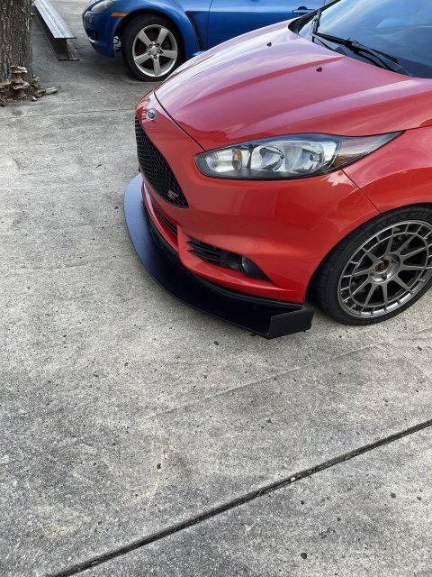

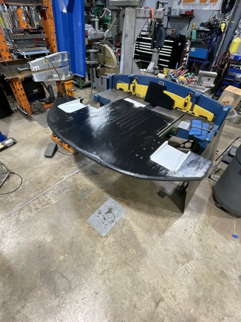

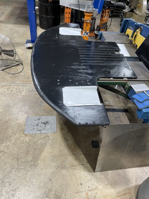

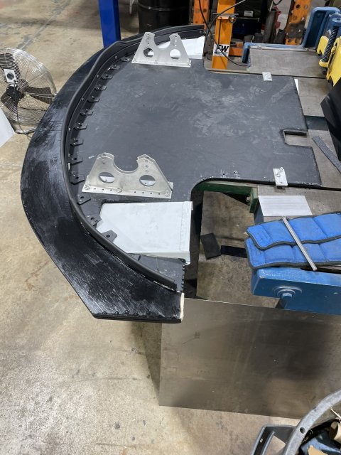

Modified my old track splitter for street/track use. Trimmed it down about 1in and added a reinforcement across the front edge to eliminate the flex I was seeing before. I also bent up some simple diffusers t test as well.

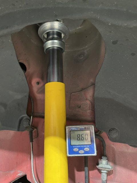

-4.6 camber and +9 deg caster before the tire hits the fender liner on the front. Gonna work on setup tomorrow and get that corrected a bit. Gonna leave caster, but will probably punk out a bit and run 2.5-4deg of negative camber.
