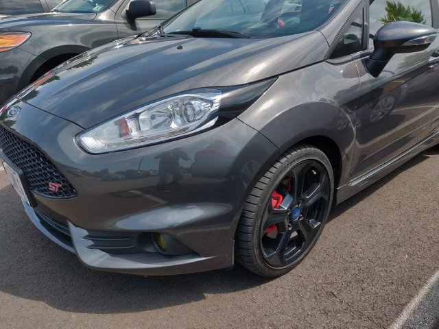

Just to confirm and close the circle with a picture, yes 75mm is the one to get. I only put one on the passenger side as the driver side OEM cap fit fine and didn't need the new one.

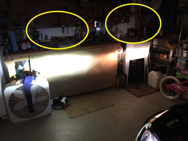

So for those wondering about GLARE, compare the circle on the left that is LED and the circle to the right that is halogen... Notice how that circle on the left is barely brighter than the circle on the right? That means glare is well in check... now because of the more blue color output too, there IS a little more overall potential distracting glare for oncoming drivers over stock but definitely not excessive. I ran these TechMax for a good 6 months and was flashed only ONCE in 10k miles because it was SUPER foggy and the light scattered too much.

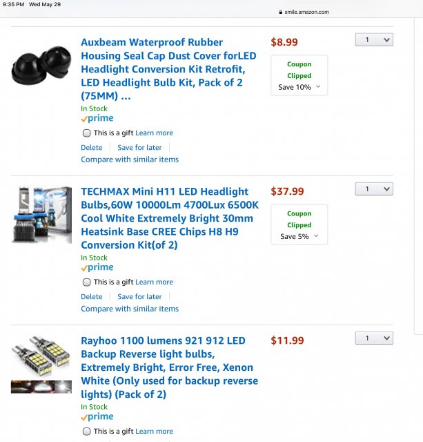

First post here, but thanks to danbfree’s guide (yes, I read through every page 😳) and this thread, will be going with the items in my attached pic 👍🏻
So, I also went with flashing brake light LED's, interested in those too? :)

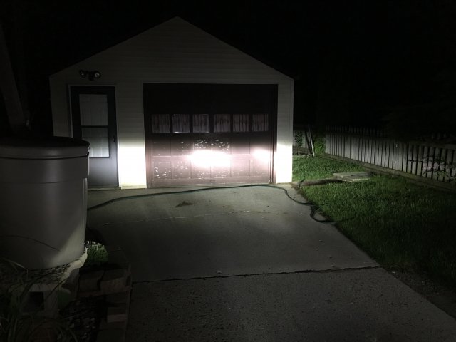

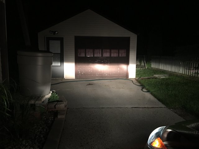

Knowing I could avoid moving her today, I parked it last night at 25’, took a picture. Installed the leds today, waited til moments ago to take the after picture.
I had to remove the housings to replace the bulbs and put the new covers on. Took more time but worked out well. One thing to note: make sure the installed led has the skinny side facing up. The tabs are not exact and I managed to install/seat the led on the driver’s side wrong (the skinny side was at a 33 degree angle from center). Luckily I caught it before reinstalling the housing.
Overall I am extremely pleased!
Cutoff is not perfect, but close: if halogen an A+, I give these an A-.
Brightness is awesome and I can’t wait to drive with them.
Bleed is....nonexistent, outside of the fuzzy cutoff.
Color is a nice crisp white with no hint of blue.
I’m replacing my wife’s headlight housings soon in her Forester, and she is excited to be getting these (that vehicle too suffers from poor headlights).
Regarding the reverse lights: Before replacement I thought the reverse bulbs were good enough. And they are! But I replaced them anyways and - wow you all are right - these reverse leds are friggin bright! No reason for anyone in a parking lot to not know I’m in reverse, day or night. 😂 8B2051C9-C734-4AD3-8D77-2A3452A971BF.jpeg 21084A33-09D6-4CC3-9304-D5D403E3C567.jpeg
