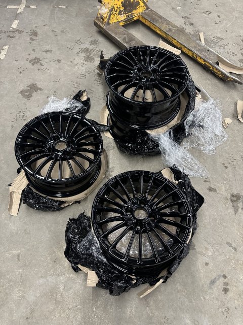

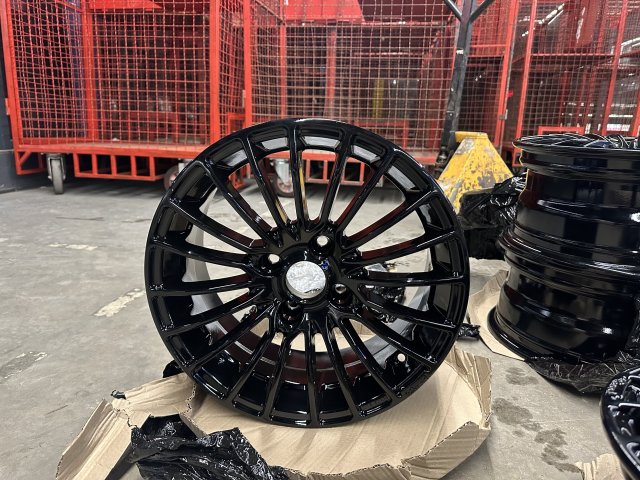

Today I bought new rims. It’s Brock B24.
Specs:
R16
ET42
DIA 63,4
7J
4/108
What tires would you recommend? 195/50 r16XL or 205/50 r16 ? I’m on stock suspension. Thank you 🙏

I have 205 45 16 on my Dekagrams, but 205 50 should work.

One set of wheels I own are 16x8 ET40 Konig Dekagrams with 205/50-16 Conti DWS-06+ on them.
On factory suspension and ride height these do not rub anywhere at all, in any and all scenarios.
When I still had Rally Armor mud flaps installed the same wheels with the same size Nitto Neo Gens did rub on the front mud flap's mounting hardware a tiny bit during hard braking, and low speed compressions while turning (like going up onto a driveway from the street).
What is the general condition of the roads in your immediate area?
If they look like one of Putin's airfield runways after your nation's troops get done bombing/droning it, you are better off with the wider 205/50 and it's taller side wall to cushion and protect the wheels (as well as your teeth, kidneys and back) better, even though yes, you will lose some turn-in response over the 195/50s on the same wheels.
