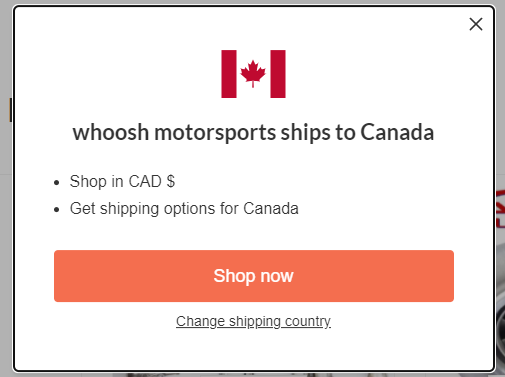

Are you sure you did not switch to the canadian priced version of Whoosh website without knowing it? Because it's still 1750 USD which gives a 2252 CAD price on the canadian site. Ron told me that he did not increase the price from 2021 despite the cost from TT and shipping did.
There's nothing to tell which one is which. Best thing you can do is open the site on a browser you never use (hello edge!) or in incognito mode. The first time you enter the site, you will get a pop up asking you if you want to shop now in CAD or go to the USD site. It won't pop on subsequent visits.
You're right. LOL....wth, I've been using this site for so long and have never even realized there is a shop in CAD feature.
