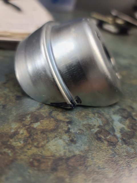

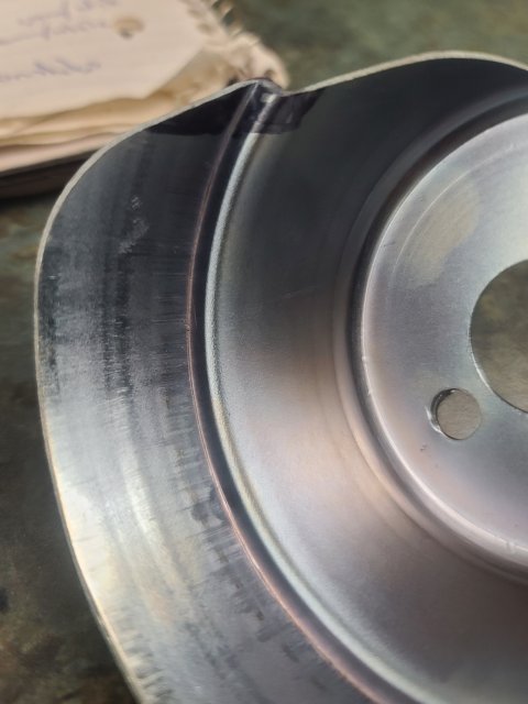

Anyone else have to grind down part of the wastegate actuator heat shield? I can't even slide the silicone coupler on the turbo inlet. Also I had to file the holes oval for the turbo smart actuator to slide in. Not a big deal, I'm just surprised I didn't see anyone else mention this from what I saw.
*edit*
Looks like the youtube guy Gapperformance mentions it basically hitting his silicone couple and he opened his clamp and put it on the other side of where it hit his shield. I filed mine down so I had some clearance. Took roughly a quarter inch off.
*edit*
i did the same. grinded it.
*edit*
I just left mine off
