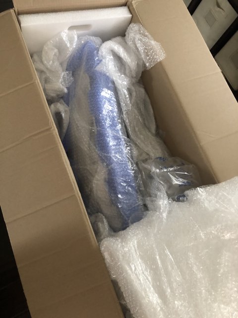

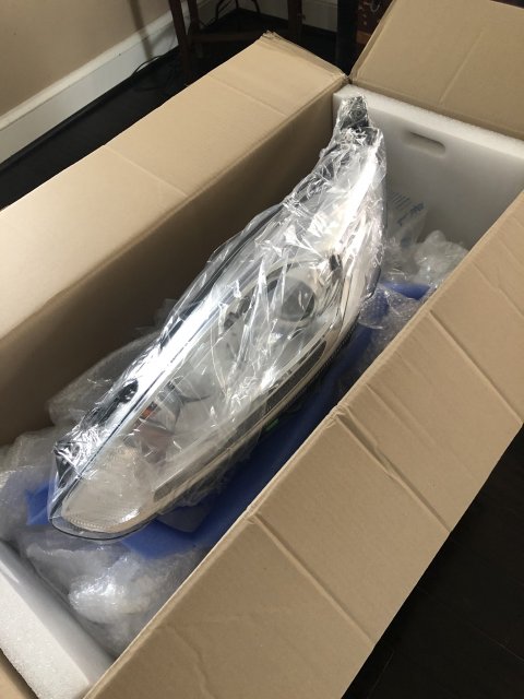

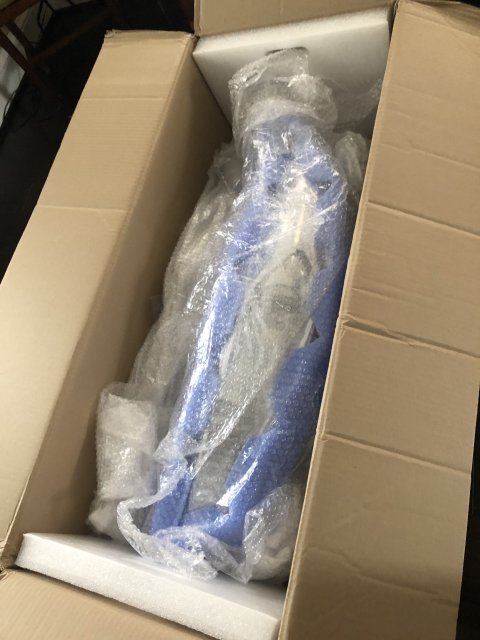

I placed my order for the Hella pieces last Friday and they were delivered today.
I read that a few people have had lights come in damaged from shipping. I think the seller has since revised the packaging, thankfully. Buy from cars245 with confidence, these things could’ve been shipped via catapult with no damage.
High density foam, bubble wrap, foam around the light, and cardboard around the mounting tabs.
I’ll post some pictures once I get them installed, just waiting on LED bulbs now.

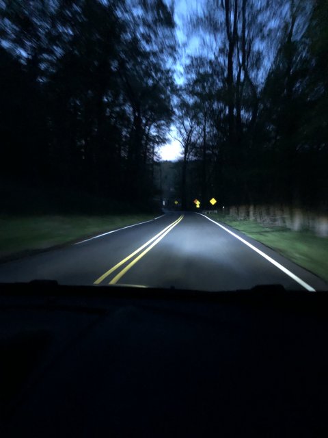

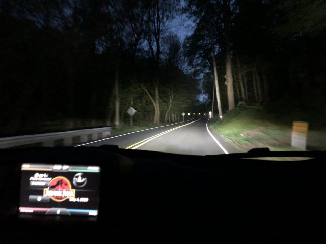

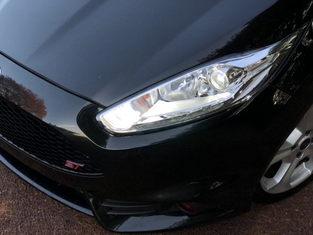

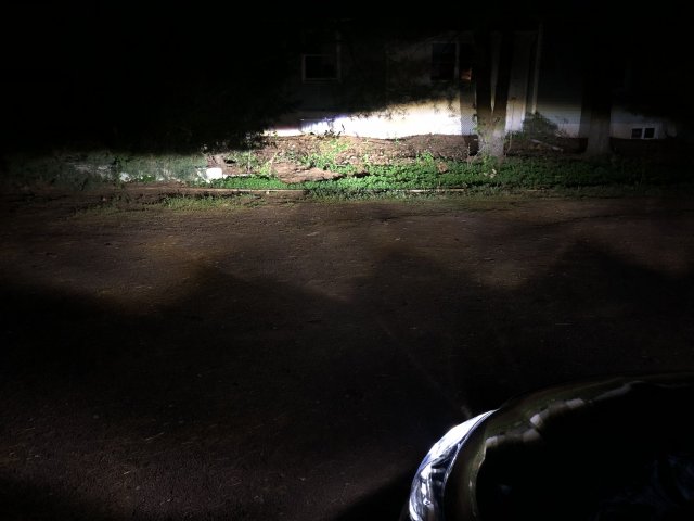

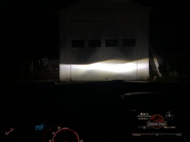

Hella OEM headlights
Katana low beams
Aukee high beams
The first picture on the road is low beams only, the second is with the high beams on.
This is easily one of my favorite modifications, it really classes things up. It makes the car appear much less “economy.” The only thing I will note - the Euro bumpers are a tiny bit different than ours, so fitment isn’t flawless. It’s really only noticeable if you look for it, and doesn’t show up in pictures.

Really? I think you're the only one who has said anything about the Euro lights fitment being off. Whats off about the fitment if you don't mind me asking?

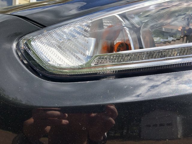

There is a small gap at the bumper closest to the emblem. Fitment at the hood is perfect, so I’m not too stressed about it.

Same here. It's only noticeable when you're looking for it. And I have the depos.

my bumper sags from the intercooler install so I'm so used to there being gaps there. I've convinced myself it's for more airflow so I feel better

I don't think its the headlights fitting badly. It looks like your front bumper is suffering from the sag that others have encountered(the gap between the bumper and hood is substantial compared to others)
