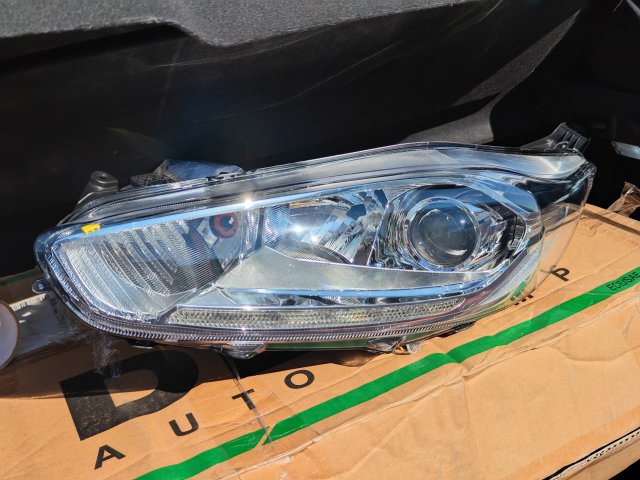

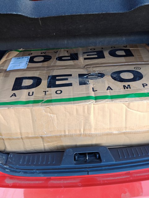

So after almost 20 days I finally got the headlights, and boy they look flawless (at least the one I openen on my way to my job from the post office), the package is great, pretty well covered, just as you can see in the picture there is a yellow plastic inside but im pretty sure I can get it out of there.
I will try to make some time to install the things within this coming days, and update you with the results.
Again thanks a lot for all the detailed info!

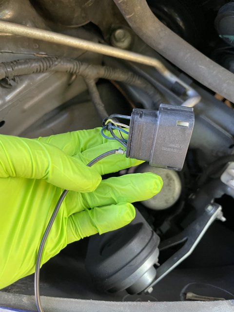

When adding the pin through the rear of the connector did you guys just shove it through that white rubber seal or do I need to dig that out? I'm guessing I have to leave it in and it will keep moisture out but not sure. Cant remember seeing it mentioned before.
Did you get this sorted? I absolutely cannot get 18g wire and pins through any of this stuff.

Yeah I was able to push the pin through the back through the rubber insulator thats in there.
Hmm. I think my pins/terminals were slightly too large - there was just no way I was getting them through the harder plastic parts, the part I had crimped onto the wire was just barely larger than the wire but wasn't even close to fitting through the plug. Everything else in the harness uses 20g wire and much smaller pins.
I took this to illustrate after I re-assembled it:
