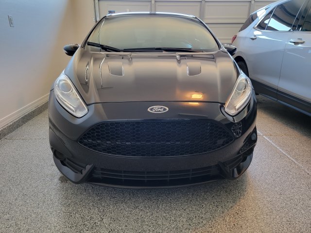

So what was the conclusion about the orientation of the Auxito H7 bulbs in the headlights. Should the LEDs be at the 3 and 9 o'clock positions or some other position?

It can be installed in three positions, the correct one is the "middle" one. If the output doesn't look right, just rotate it by 90 degrees.
