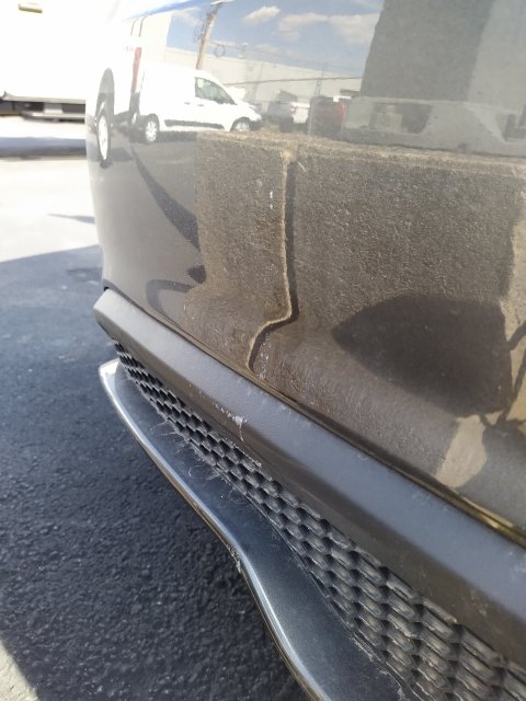

Pulled the bumper cover, replaced drivers side bumper bracket. Replaced another broken bottom headlight clip. Adjusted the TB crash bar to be as high up as possible. I still have a decent gap on the driver side bumper to fender line. Tried my best but gave up. It’s better than it was so I’ll take the win. The bumper bracket bolts rusted and one was seized. It broke the bracket and I had to cut it off. It took a little meat from the bumper mounting tab with it. I’ll never get the gap perfect without a new bumper cover. At least the hood to bumper line seems to fit better.
