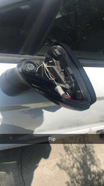

Replaced my red mud flaps with some black ones, didn’t want my car to pop out lol. Especially since it’s white. But this morning around 5 am my bro texted me my side mirror cap was on the floor in the street. Seems some rascals went around taking them off, there’s still one on the floor down the street from an unknown car. Sucks I have to park in the street.

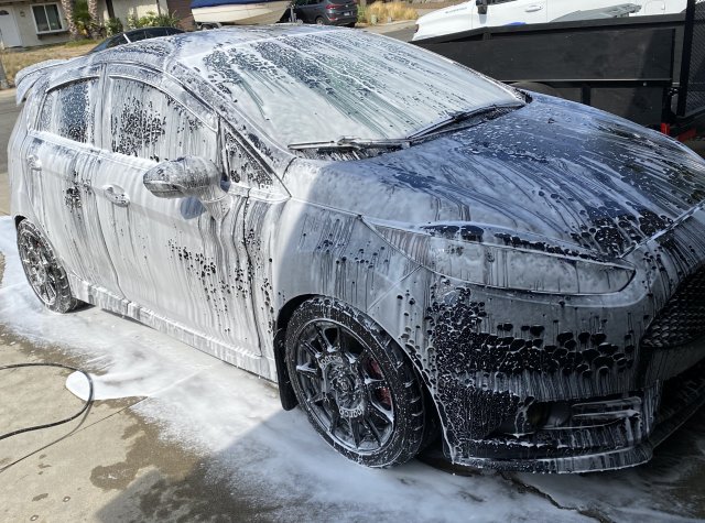

Played around with my new pressure washer and foam cannon. Its a cheap pressure washer from Walmart so its not very powerful, but it does a good enough job for me. Pic was taken after sitting for about a minute. Suds looked better before it dawned on me to take a pic

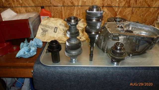

Only a few things left before I can put the case halves back together. Waiting on one bearing for the secondary output shaft on the right(reverse gear) and the input shaft bearing. Also waiting on the yellow plastic funnel used to channel oil flow that is under the primary countershaft bearing($1.42). I need to torque the bolts on the retainer bearings for both the input shaft and primary output shaft. I forgot my torque wrench from work. I still need to check the diff float but I've already installed the stock 0.5 shim that came with the transmission. According to the ford performance/quaife install instructions, checking the preload isn't necessary but I am going to do it anyway. I just gotta remember to bring my dial indicator home from work.
I was able to use a tool from our Mitsubishi diesel collection at work to press the gears on the primary countershaft, it was literally a perfect fit.
