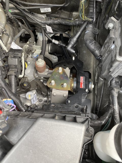

Did the Trans mount and it was a pita compared to the Pas mount.Lol.And i think i messed up something with the battery plate at the bottom as my battery box looks a little tilted to the left.Took this plastic piece out as it was pushing at the intake elbow.

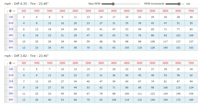

Why would you go to a lower final gear ratio? This car already burns the tires off in 1st and 2nd with any power boost. I would think going the opposite direction would be more beneficial so you could hit 60 without the shift to 3rd. Maybe a 3.55 or higher. This is an honest question, no negativity of any kind intended here. Genuinely curious to learn more about this.
haste
1,222
1,267
Eastern
Glad to answer. It's basically "free" torque. An increase of 8.7% at any given time. Ever heard of guys in rear wheel drive cars/trucks changing the rear axle ratio? Same thing.
I don't care about 0-60 times. I like to keep my drivetrain intact. I'm not a hard launching kind of guy. 3rd and 4th gear is where I have the most fun.
The change in final drive ratio will improve the useable power in all gears, except first, of course.
Countless times I have imagined myself feeling like I need to shift to second going through certain corners but keeping it in 3rd anyway. This setup will keep me in the powerband more frequently and I will also have to shift less during normal everyday driving.
I am aware the car will run higher RPMs on the highway when cruising but I don't really use this car for long trips. Plus, at 80mph I'll be out of the drone "range" of my exhaust. :love:
Here is a chart of the MPH/RPM in each gear, compared with both ratios. This is with stock tire diameter. I think if you just take a moment and study this chart to compare between both ratios, you will see the benefits of the 4.35 ratio compared to the stock 3.82.
Hopefully I answered well enough for you?
