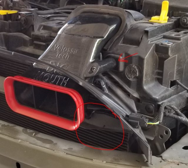

Bumper removal is pretty easy but man the big mouth is a bitch. The screw that holds it on.. Prepare your arsenal of curse words. A helping hand goes a long way so you don't have to hold, align, drop, retry, repeat.
Isn't that just for version one? Wasn't one of the improvements in version 2 the alignment where it mates up?

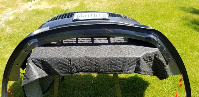

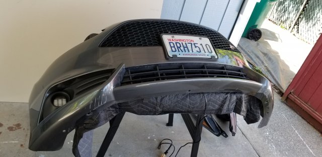

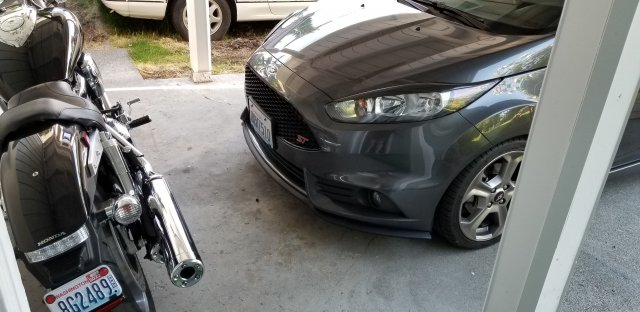

The bumper isn't that bad if you have some extensions and a wobbly to get the fender to bumper bolts from under the headlight. The rest is cake. Tip, when you go to put the fender to bumper bolts back in, put a small piece of paper towel between the bolt head and the 8mm socket. This will hold the bolt tight enough in the socket so you can fish down into it's location without it falling out, but not so tight your socket will stay on the bolt after tightening. I just installed my Big Mouth and EZLip this past weekend. I still need to get a decent pic out in the wild. I don't have any where you can see the Mouth yet.
Honestly I disagree that the Velossa Tech Big Mouth is difficult to install!
Once I realized that I couldn't get an open end wrench on the nut on the backside, I used a medium sized pair of channel lock pliers and a 10mm socket gripped in the pliers to hold the nut while you tighten the bolt. It literally took me 2mins to install it once I had the cowl cut open properly. ;)

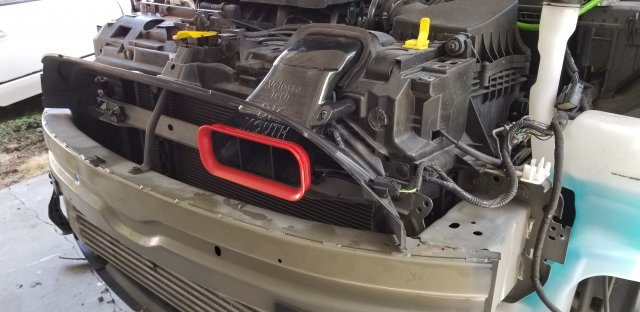

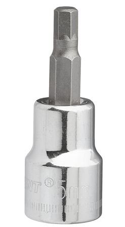

For you guys waiting to install the Big Mouth, I have a 2nd tip. Get a 5mm Allen socket
and attach it to your cordless drill with one of these or similar.
Using your right hand reach up here (see below) start the nut by hand. Then using an open ended 10MM wrench, reach up and hold the nut from spinning. Use your drill and Allen to tighten the bolt from the front and you are done in about 2 seconds.
I have the gen3 and maybe I’m ham fisted but I couldn’t get the nut on to save my life. Had to borrow wife’s smaller hands.
