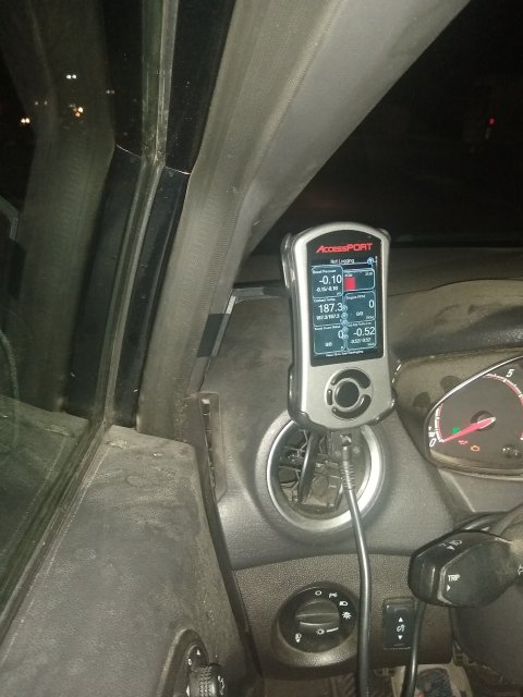

IMG_20220309_231808209.jpg My razzter Accessport mount showed up today. I really like it so far, simple, cheap and pretty strong.
https://razzter.com/product/a-pillar-mount-for-accessport-and-devices
On a different note, why is my OAR at -.52 not -1? Is it because I'm running 87? I'm currently on the Cobb stock tune so I'm not worried about it hurting anything, just curious.
