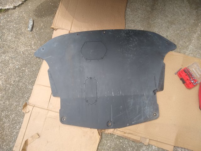

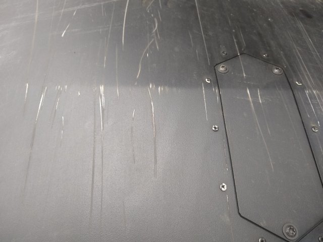

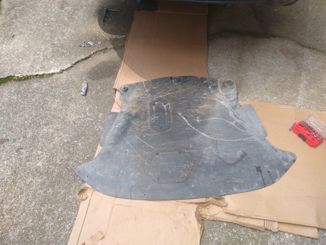

#20044
1,453
1,805
Great design on that though I don't think I've seen it before. Where's it from?
https://www.adfcustoms.com/shop/fist/14skidplate
Yeah, I like the design too. If you're doing hardcore rallycross or rally, you'll want something stronger, but this skid plate works fine for spirited gravel driving and its very light.
