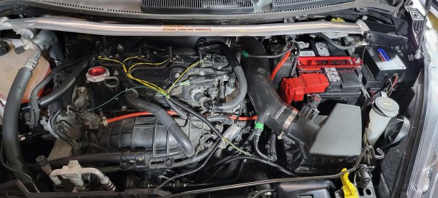

Did gearbox oil change yesterday, air filter clean also cleaned the MAF and MAP sensors, intake manifold a little. I recommend cleaning them at least once a month.. They rob power and responsiveness slowly over time. I put less oil on the air filter this time too so hopefully it doesn't dirty the sensors so much now.
Car drives so much better and is far more energetic and smoother.
