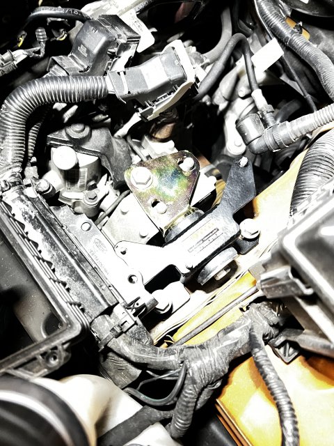

Finally got around to putting this in yesterday afternoon. Vibratechnics Fast Road passenger side engine mount added a ver slight amount of vibration at idle that will probably go away after break in. Will report back on driving impressions.
so reporting back in drives great , feels like it puts power down more solidly definitely helped the high hp torque steer.

Finally got around to putting this in yesterday afternoon. Vibratechnics Fast Road passenger side engine mount added a ver slight amount of vibration at idle that will probably go away after break in. Will report back on driving impressions. View attachment 53063
what are your temps where youre at? Probably be even less come spring summer. I had to take my car outta storage yesterday (roof antenna and 2 doors being replaced warranty) but my whoosh street poly mount nvh was harsh. The ole lady got me the vibra technics fast road for xmas. May do the other two mounts as well.
It was in the high 50’s. I drove it today in the mid 60’s.
Ya I like their mounts a lot . I edited my post above to add initial driving impressions. I am firmly of the opinion if you do one side you should do the other . I was getting torque steer to my right under high load, It took that away now all I get is a little wiggle back and forth which is totally controllable with a little steering input. It used to hook to the right when I mashed it under high boost.

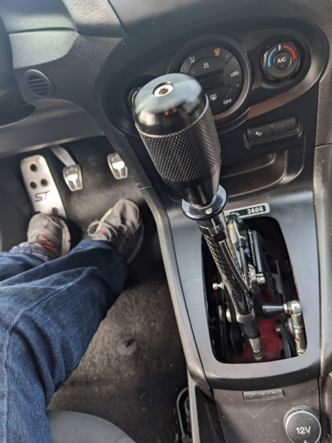

Finally got my Coolerwerx shifter installed today. Its not quite as notchy as my Hybrid shifter I ran on the CRZ but its definitely much shorter then the stock shifter. I probably need some shifter cable bushings to get a more notchy feel. The shifter position is much better then the stock shifter. I can easily reach the shifter handle now and don't have to stretch my harm out like I did on the stock shifter.

Yes, their ('fast road' at least) mounts do not have as much NVH as most of the (even lower durometer) poly stuff has, and they are much less prone to becoming like SOLID mounts when the temps dip below 30*F like poly mounts (and to a lesser extent the higher durometer, but also rubber/EPDM CP-E RMM) do.
(Something you will never have to worry about anyway, unless you take the beastie into the High Sierras during the winter. [wink])
Eventually, I need to do the other two Vibra-Technics mounts to match my RMM from them.
Badazz that you got that deal from Ron for the carbon lever at the standard lever kit's price! [wink][twothumb]

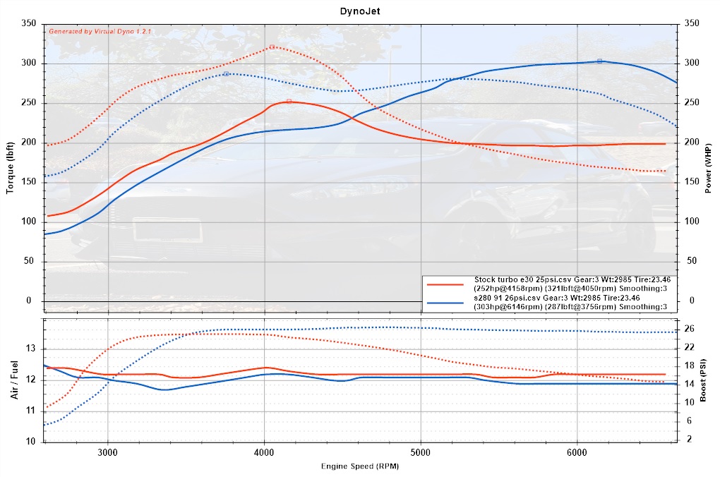

Today I joined the 300hp club! Ofcourse this is according to Vdyno but it definitely feels about right. Probably still have 1 or 2 more revisions before I start tuning for E30. Can't friggin wait!
Looks great. What fueling mods? I'd imagine you'll get more top end out of this tune still. That dip after 6200 will probably get smoothed out
I saved up and went with the XDI HPFP and the 30% uprated injectors. I plan on at least attempting to pass ca smog down the road so aux fuel wasn't really an option. I still have stock exhaust and the ST200 airbox so it looks pretty stock. That fuel pump does kinda stick out but I will probably paint it black or something.

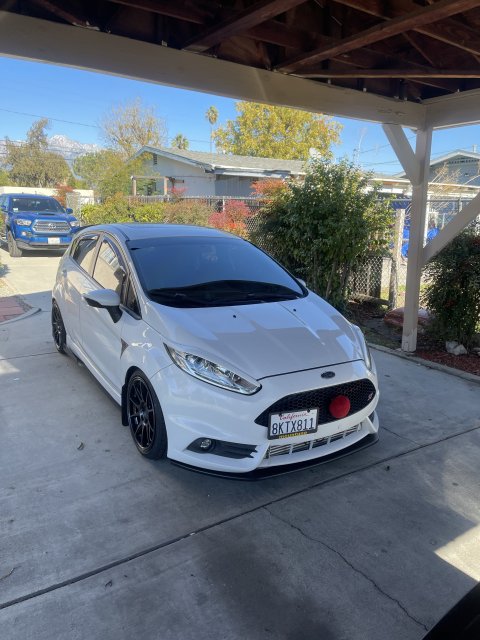

Installed my Maxton lip since my other one broke going under a puddle of water on a rainy day. My fault as It was a dip and didn’t slow down enough. I decided to get the same one. How it sits before a wash. And yes I have a rain deer nose. Gotta experience FeSTivity 219308D8-F7C4-437C-8290-ED902A2CED8B.jpeg

Installed my Maxton lip since my other one broke going under a puddle of water on a rainy day. My fault as It was a dip and didn’t slow down enough. I decided to get the same one. How it sits before a wash. And yes I have a rain deer nose. Gotta experience FeSTivity View attachment 53078
You get enough rain in one shot to actually have a deep puddle on the road? [???:)]
Was the resistance from the water so much that it ripped the splitter off?
