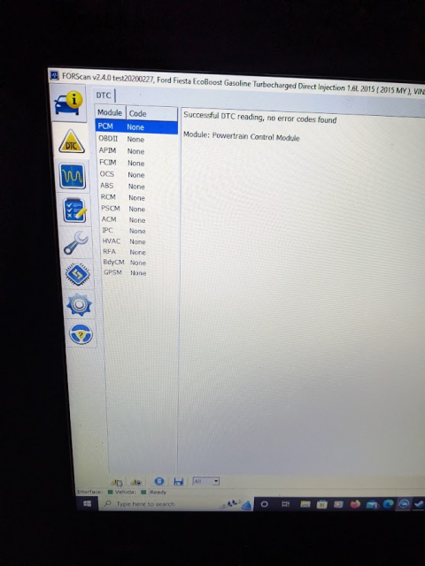

Finally got everything working on my Sync 3 radio. There were a bunch of incorrect as built values the eBay seller didnt set properly for my car. Now the clock is accurate and GPS doesn't loose track of my location. My faceplate now lights up like its supposed to. This also got rid of 2 pesky APIM trouble codes.

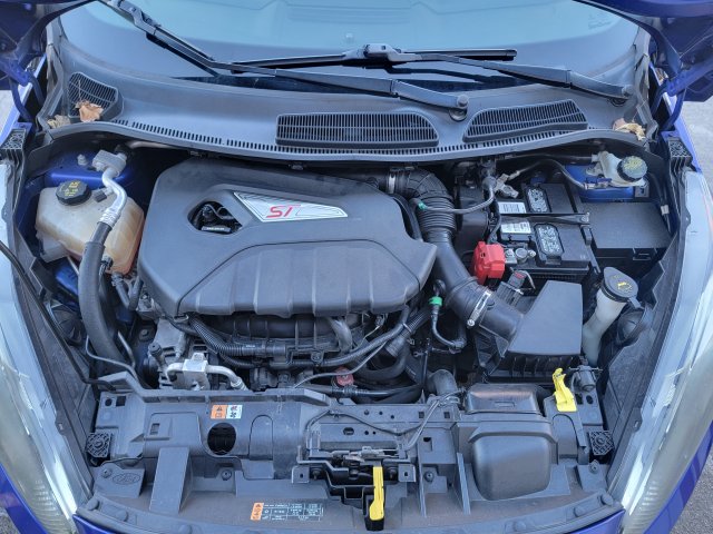

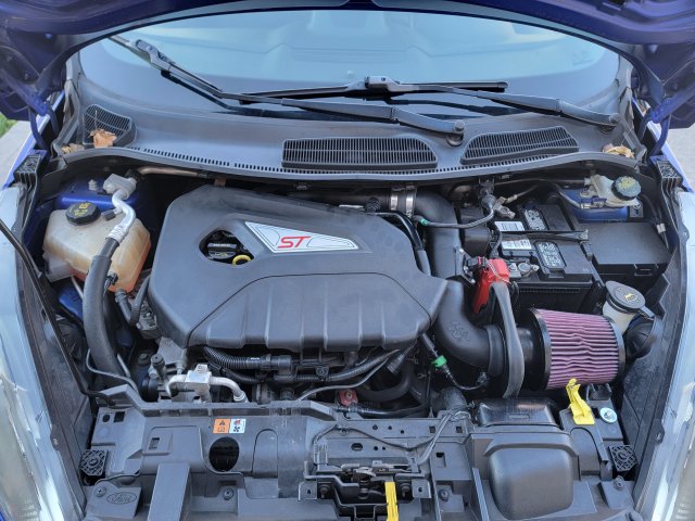

Installed about a month ago, forgot to post. Got a K&N CAI (63-2587). I absolutely love it. You can really hear the turbo spool up and the blow off valve much better, and the throttle response feels great now. Easy install too. Only problems I had were getting the intake snorkel off the stock air box, and getting the conical air filter to fit over the new intake pipe. Probably took about an hour to install, not bad at all. Definitely worth it.

Why are the pleats bent so badly on the new air filter? You may want to take a very close look at the creased areas to make sure the filtration media hasn't been compromised and allowing dirty air into your engine.

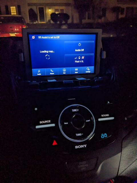

More goodness to add to the radio... Just a little Forscan magic... Still gotta do the GPS antenna USB hub and power harness but Sync 3 is already 1000x better then Sync 2.

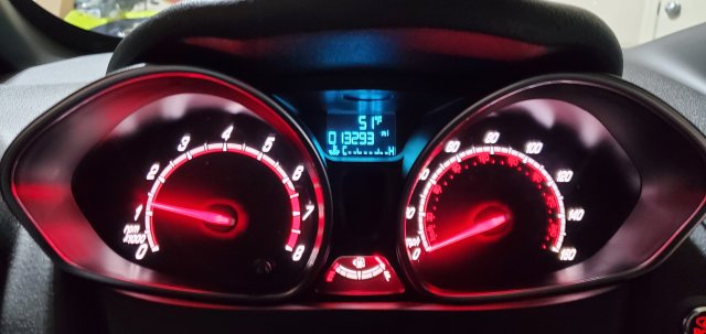

I did the same thing this weekend! Looks awesome. I also used forscan to disable my TPMS because my aftermarket wheels do not have sensors. I now have a light free dash :D

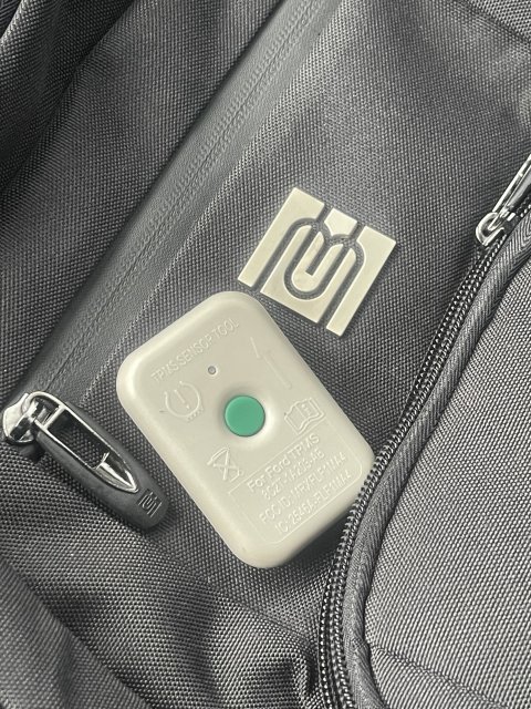

Took a leap of faith on tpms sensors on Amazon. Put them on when I installed my new wheels. The light was off for like 2 weeks didn’t need to program or anything. Yesteday I got a flashing tpms and then solid. Thinking one of them took a dump. I have the reset tool might try to reset. If no luck might just disable it with forescan. Update I follow the relearn procedure and with the tool it relearned all the new sensors and took about 1 minute lol.
