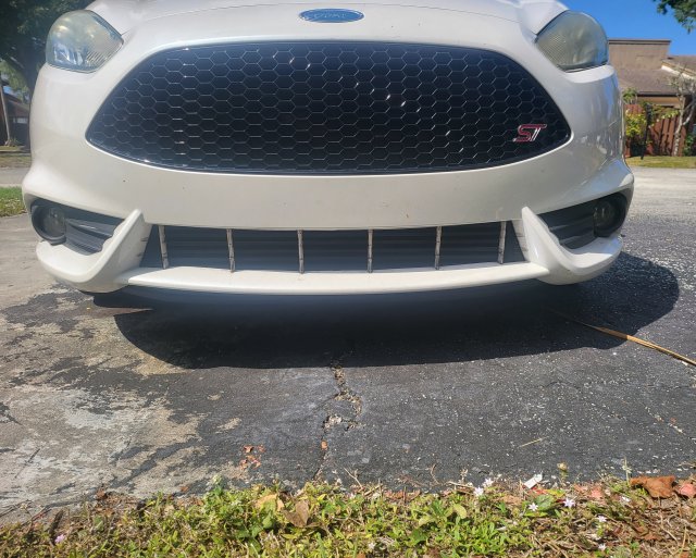

KXNGABE85
U.S. Coast Guard Veteran
44
88
Florida
Finally installed my whoosh v3 fmic. Pretty straight forward for the most part. Temps within ambient even below during a couple of pulls I did. Going with dizzy stage 2 next. Curious if anyone has cut the mounts for the trim and if you experienced any bumper sag? Thanks in advance!
