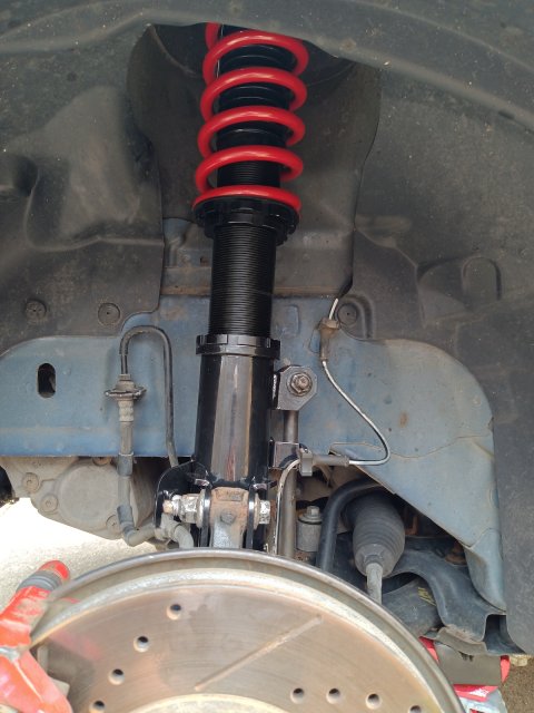

Installed the Raceland coilovers on the front. I forgot to measure the height of the body over the wheel and also off the ground. There's no information in the box on a good starting point for the height adjustment. The stock strut measures 22" from the top to the middle of the bottom hole. I set the Racelands to be 21" but that didn't drop the car at all, looks like it may even be higher than stock. I also had to jack up the front suspension in order to install the sway bar link as it's about 2.5" shorter than stock. I also don't know what is inside the grey box attached to the stock strut.
Hopefully it'll be an easy thing to shorten the coilovers, if anyone has any pointers, I'm all ears.

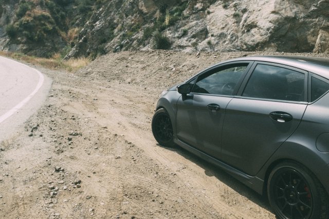

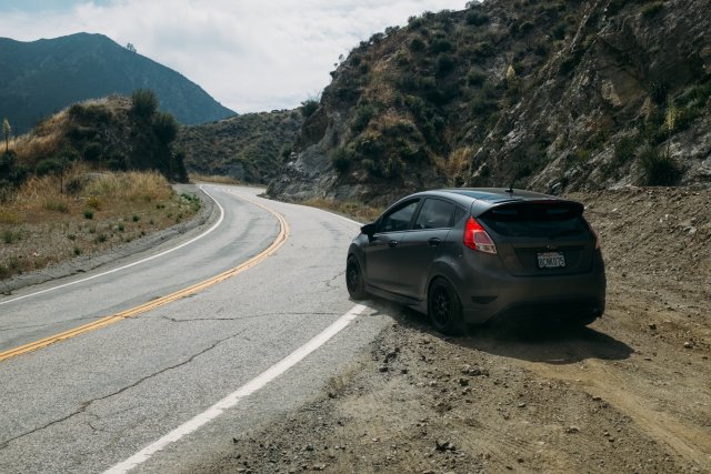

Were you driving on gravel or pavement? Either way it looks like a good time!
It seems like everyone I meet who has a speed 3 has issues with it, which is a bummer because it looks pretty fun
Mostly pavement but a lot of the turnouts are gravel. I went out again with my friend who has a Cayman and he took some nice shots on his camera.

Grey box attached to stock suspension is a weight to help with nvh tuning. You don't need it.
