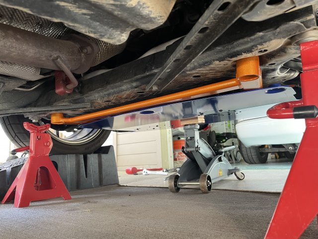

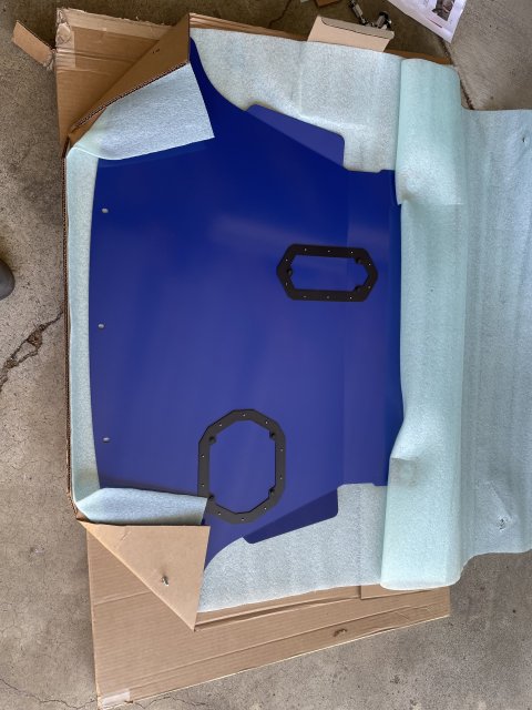

Finally fitted my ADF skidplate overtop of the Swave and Summit 4-point brace! Have cake and eat it too. Still have more ground clearance than I did with the Pierce 2-point, even with the skidplate. It came very well packed!
I ordered it back in January when they were out of stock, and for a little extra ($30) they had it done in a custom color. FYI the new skidplates have oil and filter access panels like the Focus plates. They also moved the filter hatch for me over to where I will eventually install a relocation kit (normally its under where the filter is obviously).
More photos in the build thread:
https://www.fiestastforum.com/threads/feisty-the-family-car.30825/post-502439

How do you change the Filter on the front of the block?

For now I’ll take the Skidplate off, but oil analysis told me to go another 8000 miles and I’m running Amsoil longlife filters, so it won’t be more than once (plan to install the relocation as soon as the filter comes off next). As I said, the normal ADF plate has the big access panel in the “correct” location for the filter.
Skidplate is only 8 bolts, so it’s not too difficult.

Mine has no access doors at all in it, but it is just four 19mm bolts and it is off, the back two just need to be loosened, as the rear mounting points are slotted.

I have the same skid plate with the access points but I normally just remove it entirely because it’s easy and allows me to inspect the bottom of the engine and transmission

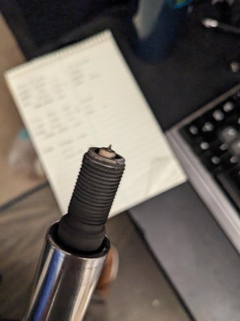

A little tune-up after my trip south to Tail of the Dragon. Air filter (FA-1914) and fresh NGK 6510/LTR7IX-11 spark plugs. I threw a P0303 a couple days after returning; cylinder 3 negative electrode was completely gone! :oops:
