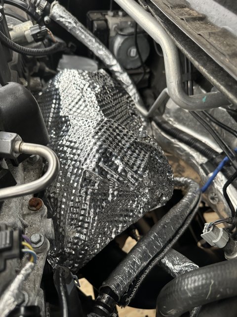

From Yesterday but got busy with reality. Installed the cerakote’d Whoosh crossover pipe, heat shield more like a blanket I fabricated for the airtec manifold, and started the install of the Radium oil catch can on the crank case side, also got the battery box back in. Ordered up some wedge washers and new bolts for the Dpro Camber plates as well. They will need to be slightly modified but should do the job. I should have the correct hose for the catch can coming soon so thats on hold at the moment.

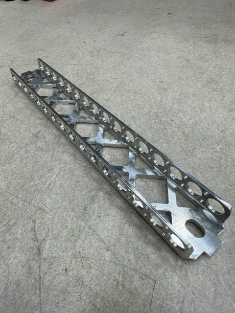

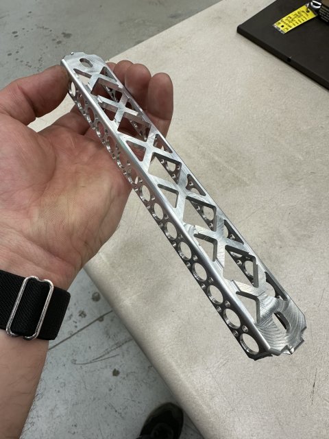

Nice battery tie-down! Where’d it come from?
296
355
Morris, CT, USA

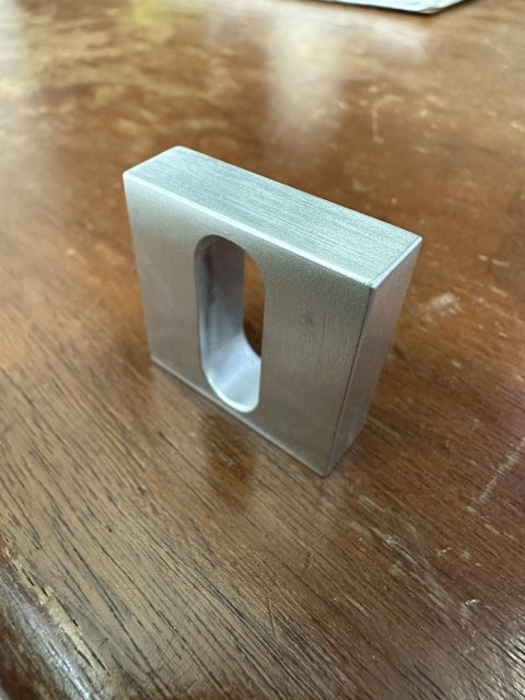

Thanks I may have made it at work while I had some down time. I do cnc machining for a living. Heres some better porn of it.

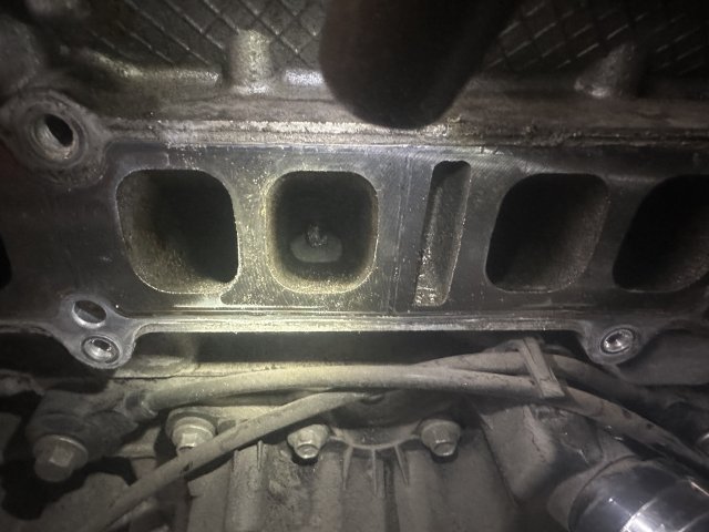

Cleaning out my intake valves as I posted on another threadI was having intermittent misfires at idle that were starting to become constant. Maybe this was the culprit 68k miles and been running a dammond catch can since 2020. I did switch to the revised mishimoto a little over a year ago. IMG_2087.jpeg IMG_2090.jpeg IMG_2088.jpeg

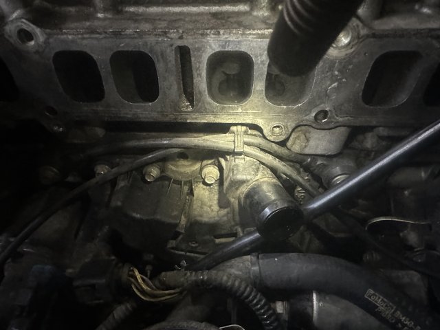

My mistake I posted a thread about having misfires at idle. But I just closed the valves and sprayed carb cleaner in there. Let it soak then use some picks to break down the carbon. I don’t have compressed air so I used a piece of microfiber cloth and I used the pick to get in there. Did a decent job. Here are some after pictures. So far it’s at operating temperature and not misfiring. Idle is a bit smoother too. IMG_2098.jpeg IMG_2094.jpeg IMG_2103.jpeg IMG_2104.jpeg

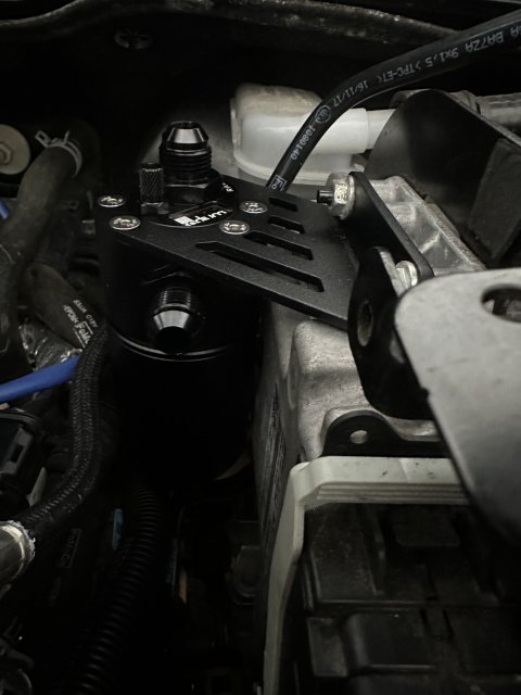

I may have found a little downtime at work to make a spacer quick for a pro alloy coolant reservoir. Im having an issue with fitment of that with the Radium OCC but if I mount the reservoir ever so slightly different and use a spacer while slotting out the stock mount (the mount closest to the front of the car/radiator) it should swing everything just out of the way of interference with the connecting lines. Guess will find out later if I can get on the car. Anyone else run into this issue?

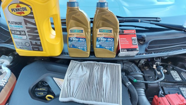

Well not today but in the last week. Oil and filter change,transmission fluid change the fluid still looked really good with 15,000 miles on it, and boy did I forget how much of a mess it can make when it shoots out the drain plug. The transmission does shifts a little better but I will probably wait till at least 30,000 miles next time. Also did the cabin air filter looked pretty decent for having 3 years on it, but I do keep it on recirculate most of the time. Also ran a bottle of Red line fuel system cleaner from full to empty before I did the oil change. 20231027_130826.jpg
