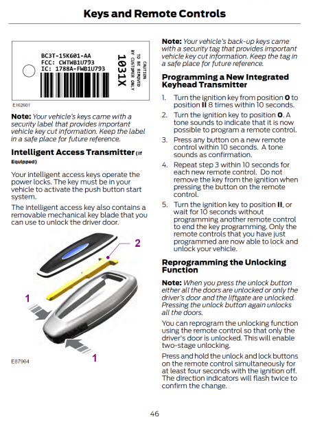

Has anyone tried the procedure in the owner's or/and service manual?
It'll cost you a little time but should be able to avoid taking it a third party to program a remote.
There also seem to be plenty of videos.

The instructions seem to be geared toward an actual key:
Turn the ignition key from position 0 to position II 8 times within 10 seconds.
Turn the ignition key to position 0. A tone sounds to indicate that it is now possible to program a remote control.
There are equivalent "positions" or ignition states for push-button start. These specific set of instructions from the owner's manual refer to push-button as "intelligent access". I have a Service Manual as well but don't recall running across that like I have the Owner's Manual. (could look for it if anyone wants the info)

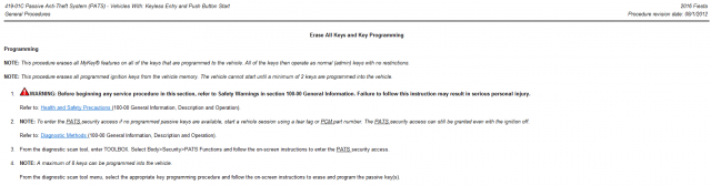

I thought that video was going to do the trick until I read step one. 1. You must first have two programed keys and all of the keys have to be in the vehicle.
I only have 1 working fob.
4,379
2,908
You'll need ForScan. Yes that procedure only works if you have all keys and want to add another. I don't think we want a situation where I can get a replica key from Amazon, punch your window or pick the lock, hop in, quickly add that replica, crank up and drive off.
