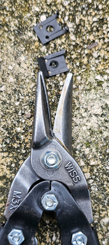

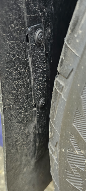

I havent really done this today but has been like a couple of days project
who here thinks rally armor mudflaps front bracket sucks with the bolt solder on the bracket? i do, so modified my and ended up like this
what i did was:
1) got the bracket with the 2 solder bolts and grid them out then make a hole the same diameter as the bolt that was solder in in the same location (no pictures of this sorry)
2) bought this from autozone
3) cut the thing that has the thread from the part that doesnt have a thread from the u-nut, like this:
4) hammer the part to make it flat and made it like this:
5) crazy glue that part to the bracket so it stays in place and you just install the mudflap like usual
been a week since i did this and the installation has been solid, hasn't loosen at all

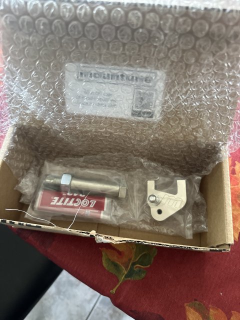

View attachment 59230 Picked up a mountune short shift on Black Friday. Been wanting it for a while but never picked it up. The whoosh one is great, but I wanted to try out the 30% reduction. Also snagged it because I was afraid mountune will discontinue it soon lol
That one was suggested to me for subtle reasons when I inititially got on here and started asking questions and researching. Something about the angle geometry it has on the cables. Anyhow good choice.
14,790
7,249
A little bit of a pain to install, but WELL worth it once done!
Mine has been in the car for almost 7 years and 35K miles, and with that 30% reduction, I do not have any desire for either the Boomba interior shifter, or the Coolerworx, as this is smooth and reliable with no 'notchiness', or glitches, at all. [wink] [thumb]
Mine has been in the car for almost 7 years and 35K miles, and with that 30% reduction, I do not have any desire for with the Boomba interior shifter, or the Coolerworx, as this is smooth and reliable with no 'notchiness', or glitches, at all. [wink] [thumb]
I also picked it up because I was reading on how the coolerworx shifter seem to have their share of problems, I was interested in it at one point. I also already have the solid bracket and base bushings, should be fun
what i did was:
View attachment 59220 View attachment 59221
I cannot stand RallyArmor's mounting technique AT ALL, and currently have mine uninstalled (the front mounting points rubbed against 205/50-16 Neo Gens on Dekagrams, even at full factory ride height!).
If I ever get around to reinstalling flaps, I will just use the pop rivet mounting method that BRGT350 used to mount his Sparco flaps many, many years ago.
But your mod above to the RA mounts would solve any rubbing problems if one was hellbent on retaining the rest of that kit's mounting hardware. [thumb]

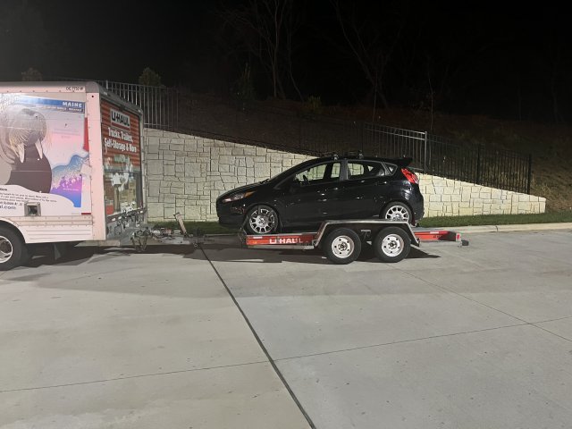

Towed it home from the Tennessee border because my alternator died 4 hours away from home and no auto parts stores in the mountains carry in on the store. Between renting a U-Haul truck and trailer and buying the new alternator this is going to be an $800 alternator job.
First time towing my car, everything went fairly smoothly although the fiesta being lowered made it a pain to get on the trailer.
I've had all 3 styles now* The Whoosh version...The Mountune version and now the Boomba shifter assembly. Out of all 3 the Boomba is the best IMO. The install wasn't too hard but if i ever wanna revert to stock it'll be easier. The Mountune is the best out of all the adapters though and the most smooth operating by far.[driving]
