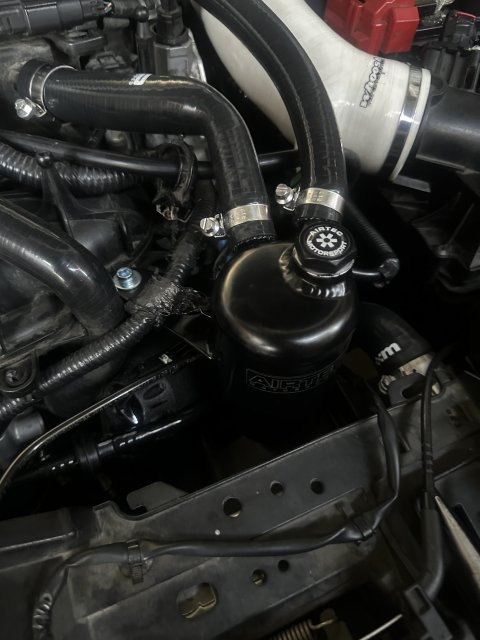

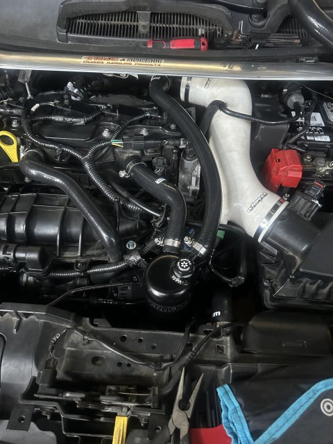

#4150
14,705
7,190
^^^How difficult is it to get to the drain valve/hose on that setup, or do you have to remove the whole thing in order to drain it?
#10551
449
748
seems I have to take it off the bracket and take the lines off to drain it. But the dipstick hole is pretty big imma just gonna suck it out
#12462
2,581
3,028
They don’t. I have a mishimoto one currently on the pcv side. Kind of a pain to drain. I might switch to a dammond

Threw on a airtech crankcase catch can, it was a pretty tight fit with the blow off and the evap harness.

#10551
449
748
I wonder how much will end up in the crankcase side. Keep us posted! May inspire me to install the radium one I’ve had for 3 years and done nothing with
I will! I did notice when I took off my stock turbo there was some crud on the turbo inlet so maybe that will help preventing some of that but I’m also curious how much oil it will pick up

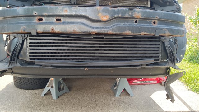

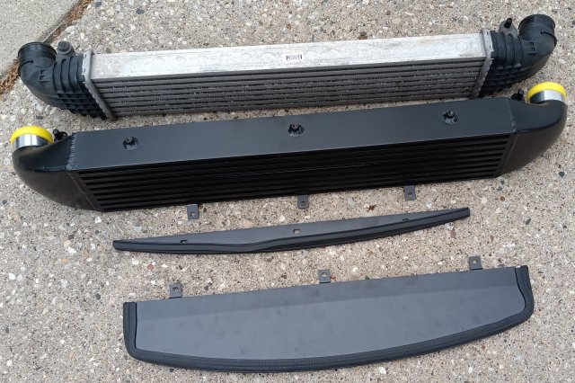

Installed an aftermarket inter-cooler I got off ebay. It comes with a splash guard which I was able to use, but not sure where the so called wind deflector is supposed to go. The fit was perfect once i pushed down the middle tab enough so it had a downward slope.
Took it for a short spin around the block, and I am NOT liking the 93 octane stage 2 tune from Cobb. It made some horrible noises under the hood and was not very smooth when compared to the stage 1 - 91 octane tune.
I'm going to try the Stage 2 - 91 tune tomorrow and hopefully it's better.

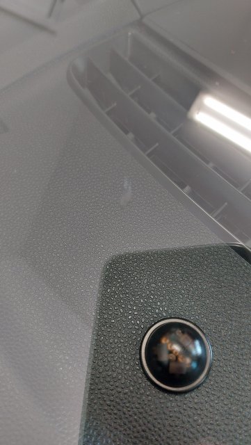

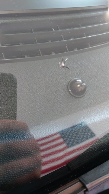

Fixed a window chip for the first time using one of the many window kits, and I believe it turned out okay. Window chip repairs are free with insurance, but I did not want to make an insurance claim.
