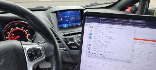

Finally re-removed Xm and Sony after upgrading to sync 3. Also did the in dash climate control because why not? My Forscan license was 2 years out of date but they sent me a 2 month trial anyway. The previous owner installed the tweeters on the dash, lol. I don't mind em.
edit: Okay this is a pleasant surprise. It chimes less now. I have no idea which setting did it. I did the climate control, sony/xm removal. I also changed the boot screen/theme ui settings but those didn't make a difference in the UI. I wonder if somehow that changed the chime behavior.

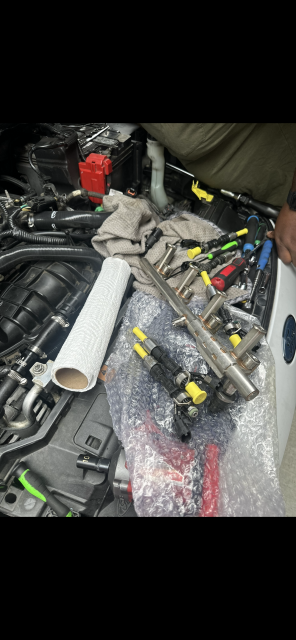

Installed my XDI 30% injectors. Going to do my datalogs tonight. 2 injectors came out with the rail and luckily the other 2 weren’t stuck in the head, but an injector puller got them out with ease. I also put a new HPFP cam tappet since I was there.
that looks like a big job, how long did it take?
