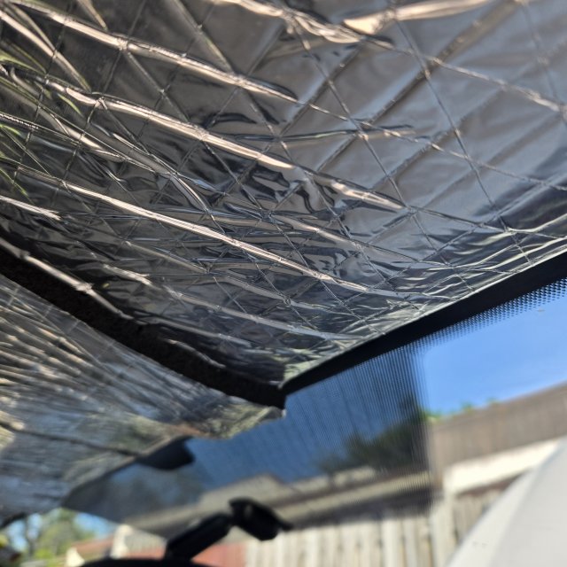

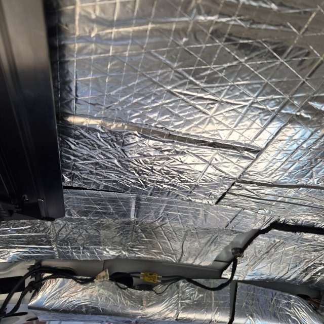

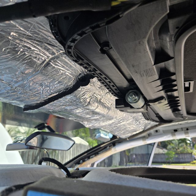

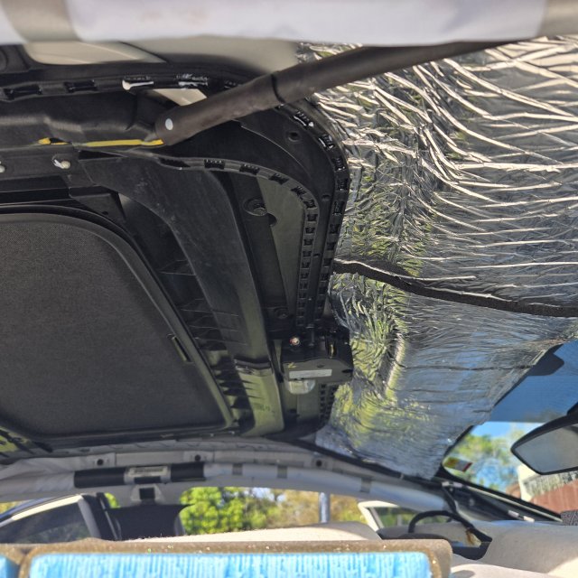

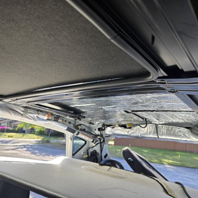

So, couple of things since my last post.
Yesterday got my BG Shift Trans Fluid done and my goodness what a joy it is to drive this car! The throw is smooth as butter and works really well with short shifter mods, I have both bushings front and back. Shifts are crisp and sharp with no hesitation and if you ever had a difficult first gear where it doesn't want to go in gear, totally GONE!! Do it if you haven't it's worth the 70 bucks on whoosh.
Today I pulled the headliner and put in some insulation/sound deadening and my goodness!! Every single rattle completely GONE!!! Honestly can't believe the difference. CP-E Motor mounts trans and passenger (tons of NVH) Muffler delete, VIBRA Technics RRM, bracing all over front and back, Koni Yellows and more. Tuned by dizzy, Stage 2/E30 and I can barely hear the pops anymore!!! Insanely good and the stuff I got was super lightweight from also Amazon for 30 bucks during a sale, it doesn't add much at all in terms of weight. Wish I Would've done this sooner. Take care amd drive safe Fiesta gang! ✌🏼

I did a strip of sound mass above the headliner in my impreza/9-2x and the cabin noise reduction was life changing. Especially in the rain. Good find. You don’t even need to cover the whole thing. Just 75% or so of the flat roof parts. so worthwhile I appreciate the reminder and have it on my list.

Nice work, how difficult was it to pull the headlner?

Hey,
Not bad at all of you aren't intending on removing the headliner from the car completely since you would need to disconnect the water lines and wiring harness.
I decided to just drop the liner which gives you plenty of space to reach in and attach the sheets no problem. It's honestly insane how quiet and refined the car is now, 100% worth it!

You are spot on when you said "life changing". It's completely transformed the car and daily driving is so much better!

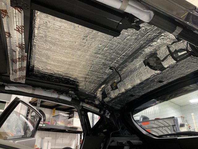

I just did this on mine over the winter break and I can absolutely attest to the fact that it's life-changing. What a difference ! Thanks @KXNGABE85
I'll have more details on my build thread soon, but the gist of it is :
80mil butyl insulation as a first layer : LINK
394mil closed cell foam insulation as a second layer : LINK
Wow! The 3.5k-4.5k RPM resonance on downshifts is attenuated to a large degree and the cabin is much quieter.
