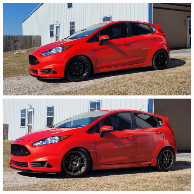

Swung by Discount tire and had them swap the tires/wheels around.
The old 215/45R16 RT660s went onto the 16x8 Decagrams.
The new 205/45R16 PS31s went on the 16x7.5 Lockouts.
Reasons. Mostly looks. The narrower tires look better on the narrower wheels, not as much sidewall buldge, and the Bronze IMO looks better on the car than the black wheels. The Lockouts are a bit heavier than the Dekagrams but these will be street wheels with summer tires and the Dekagrams will just keep living with either RT660s or RT615Ks for more spirited driving than commuting.

That definitely makes perfect sense! [thumb]

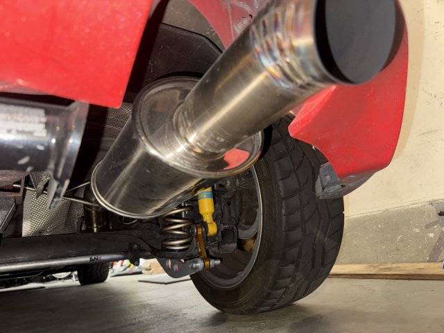

FL was snowed in so these 8” Swift springs took a couple of weeks to arrive. #300 vs the #250 10” spring I just took off, paired with off the shelf Bilstein B6. Primary goal is to have the torsion bar stay on the softest setting to keep from becoming a cornering tripod out on the racetrack next weekend. That way I can focus on increasing front mechanical grip with a larger contact patch next… going to get the car weighed and cornered asap

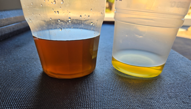

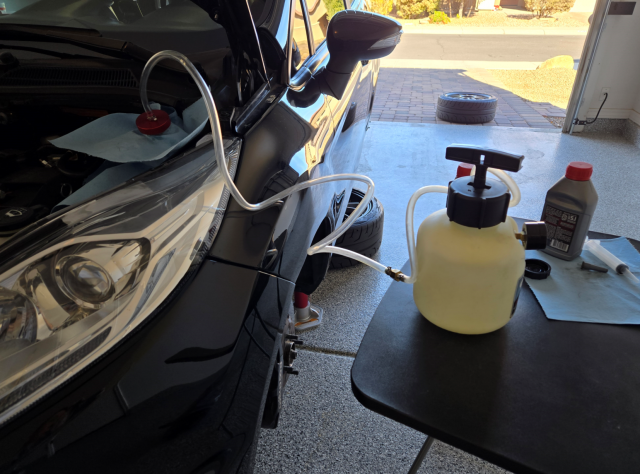

Did a brake fluid flush and tire rotation other day.
3 year old/18K mile fluid on the left vs. new fluid on the right for comparison. Both are Motul DOT 5.1.

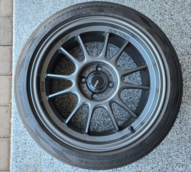

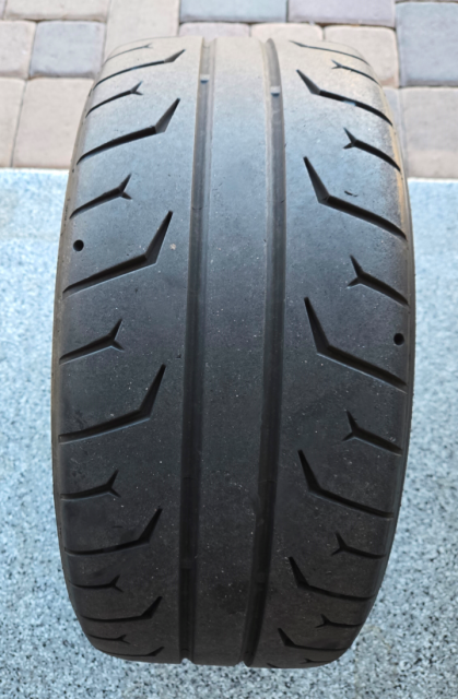

Conti ExteremeContact tires have a year/6K miles on them so far. Noticeably more traction than typical street summer tires. They are designed for endurance racing so they do well on the street and even driving on the highway in the rain. They still have decent amount of tread left, I'd be happy if I can get another year/6K miles out of them.

How wide are the wheels, 7 1/2 in, 8 in?

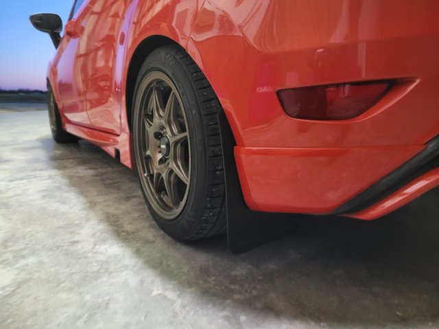

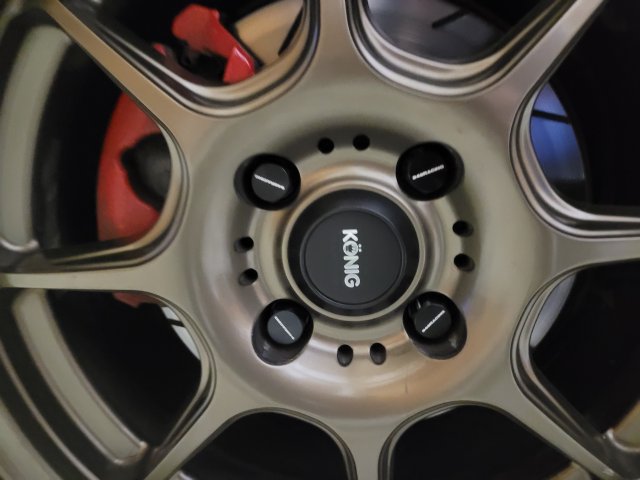

@initiation sold me one of the best put together used parts kits I've ever bought. A set of RallyArmor mud flaps complete in the box. The only missing parts were the foam spacers. No big deal there.
Apparently one of the previous owners had put these same flaps on before because all the holes and some of the hardware were still there.
I also swapped out the McGard splined lug nuts with forged lugs from 949 racing.
So I saved about a half LB in lugnuts then turned around and put LBS back on in mud flaps 😅

Thanks, I was curious how wide the wheels would need to be for that size tire, I was guessing 8".
FYI I am lowered by .75" and tires rub a little bit when I hit a bump while cornering. While increasing camber or raising the car should take care of it, it's not bad enough for me to make changes.
