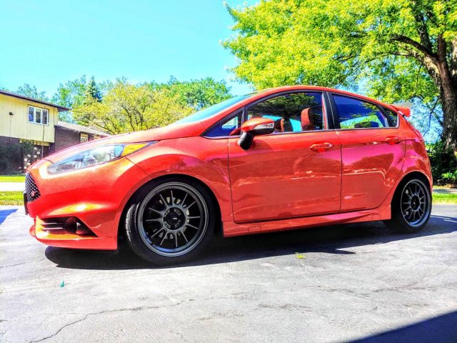

Alright so what I ended up with was the Koni Orange in the rear and bilstein B8's in the front with H&R Sport Springs. Does it rub? Occasionally the fronts with rub but only if there is a big bump or a big bump/sharp turn combo. I put camber bolts in and have the wheels wedged out a little to compensate. Does it look cool? Hell yes! Does it handle like it's on rails? Hell yes! I have had some spirited drives with this setup and a 7 hour roundtrip through some country roads and holy crap, it makes you laugh when youre body is at a 45 degree angle in a turn and the tires arent even squealing! Had to do different front and rears because I was near impossible to find bilstein rears or Koni fronts...
Sent from my LM-G820 using Tapatalk
